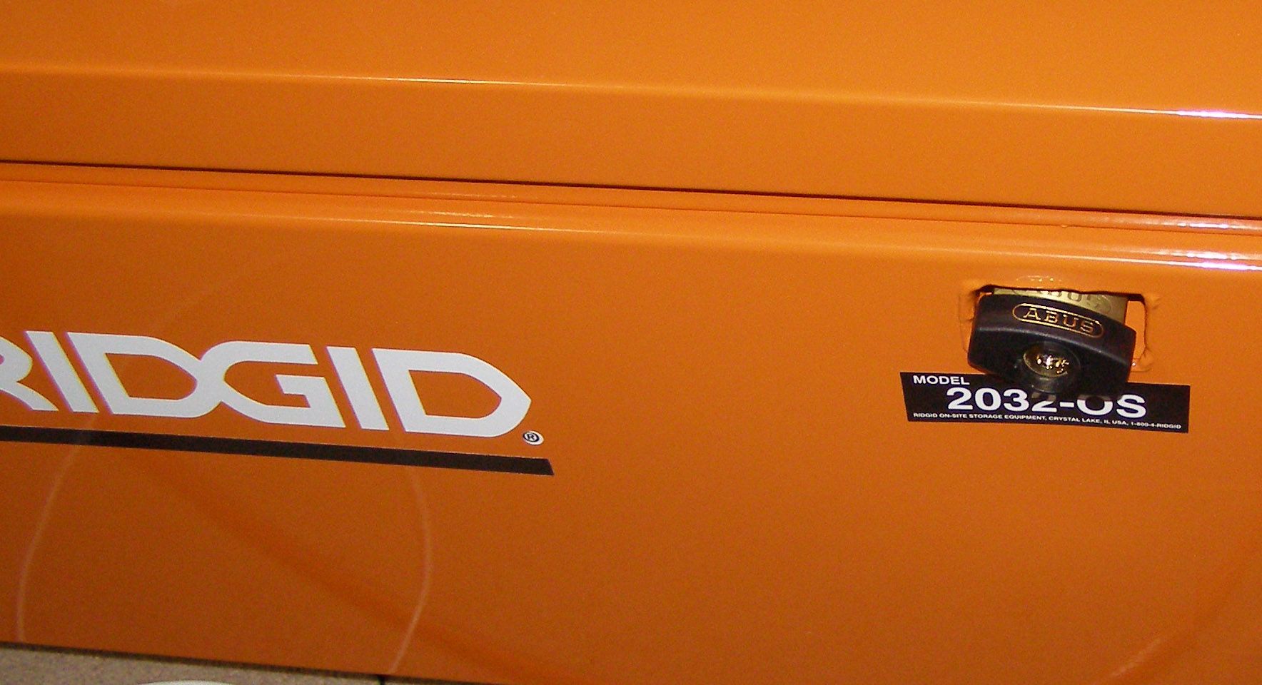

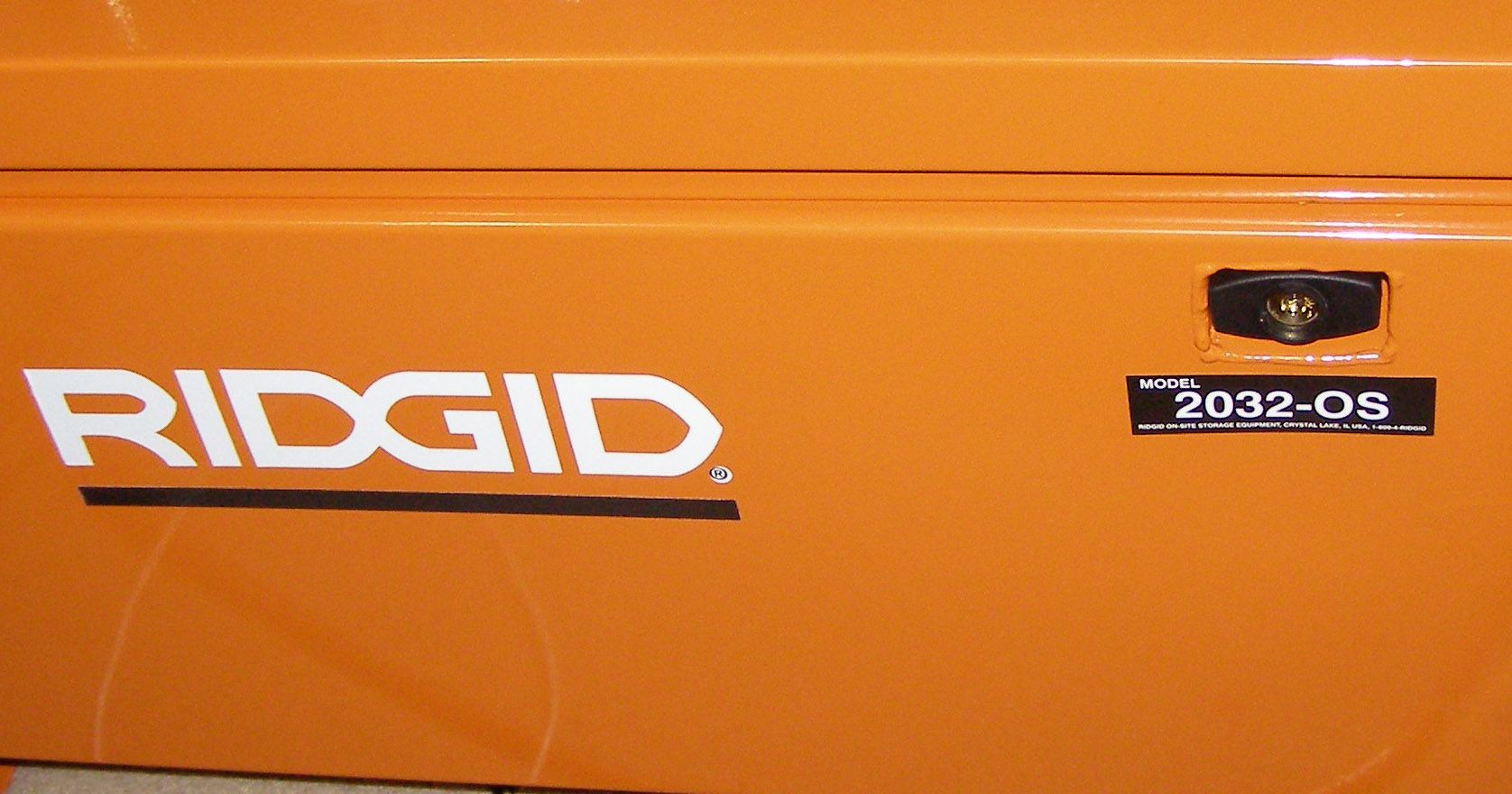

Ok, I finally found a set-up I am content with. I went with two of the ABUS 83/45 brass padlock with the Abloy cylinder, Protec Elite Key profile/system with a 1" shackle height clearance. One of the locks is key retaining and the other is not (Z bar was removed). The locks also have the ABUS End Cap on them with the key hole cover and loops removed.
https://securitysnobs.com/ABUS-Brass-Pa ... -Core.html
https://securitysnobs.com/ABUS-End-Cap- ... dlock.html
Here is a picture of the lock in the closed position.
Here is a picture of the lock in the open position.
