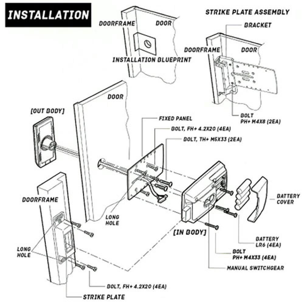

Postby rt22355 » 27 Jan 2016 8:29
Also ... they have this deadbolt variant with no override key http://www.samsungdigitallife.com/SHS-3321.php
I am wondering if it is more or less secure than the latch model ... with the deadbolt variant the electronic deadbolt is inside of the door itself but is accessible from outside ( after breaking outer part ) via the hole that needs to be drilled during installation . ( I think the hole needs to be drilled to accommodate another variant which does have mechanical key override ... they should have separate installation guides for the two deadbolt variants .. )
Versus the the latch model whose electronic bolt is completely on the back of door ( not accessible via a hole ) .
Deadbolt model schematic ( there is two variants with and without mechanical key override ) : https://2ecffd01e1ab3e9383f0-07db7b9624 ... a14784.pdf
Latch model schematic http://ecx.images-amazon.com/images/I/6 ... L1000_.jpg

Postby Squelchtone » 27 Jan 2016 9:35
Having looked at the pdf's you linked, I have an idea for an easy attack on the model that does not have a cylinder, but I won't discuss it in this post. It does involve drilling a hole but that's all I'll say here.
I sense you want one of us to give you approval or reassure you that yes, this is absolutely the safest lock you should go with and you can sleep well and feel safe, but I don't think we can do that. I wouldn't worry about someone picking or bumping or hacking the lock, a swift kick to a door is all that is usually needed unless the frame and strike box have been reinforced.
