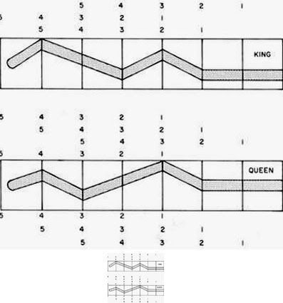

Postby shdwdrgn » 28 Nov 2006 2:01
Based on the info from this thread, and the template I found from another, I've made some changes and resized the pick, the results of which I would like to contribute.
Some info about this template... The print size should be scaled to 4.75" wide. The pin-spacing was scaled to approximately 0.160" (assuming that will help it to work in more locks). Also the shank leading into the handle has been tapered because my picks based off the original pattern would bend when trying to lift 5 pins.
I can't claim these work, as I'm still a newbie. One side of the queen is a good fit for my house lock, yet I have been unable to get the pins to set. However I believe the scale of these picks to be correct, and the ridges nicely line up with the pins of my test lock. If I made some gross mistake, feel free to point me in the right direction...
shdwdrgn

Postby Jason13 » 3 Dec 2006 0:04
I only have a bench grinder but i guess i could use both of the wheels to come up with that :P
Thanks romstar for the templates.

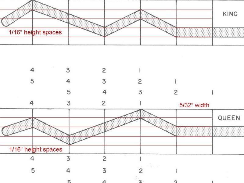

Postby Peter Martin » 12 Dec 2006 16:12
I found that making the King & Queen picks was easier if I first scribed a full grid onto my picks.
I scribe the patterns onto my picks using layout ink instead of using a template. The grid also gives you a good idea of how far up and down to make the peaks and valleys of the picks. My pick stock is 1/4" high so I scribe three lines across, each 1/16" inch apart. Then I scribe the width lines 5/32" vertically apart from each other. After these lines are scribed (using layout ink), I then draw the pattern.
Peter Martin
Posts: 396
Joined: 1 Aug 2004 0:14
Location: SD
King-Queen-on-a-grid
Postby Peter Martin » 12 Dec 2006 16:14
Like this...
Peter Martin
Posts: 396
Location: SD
