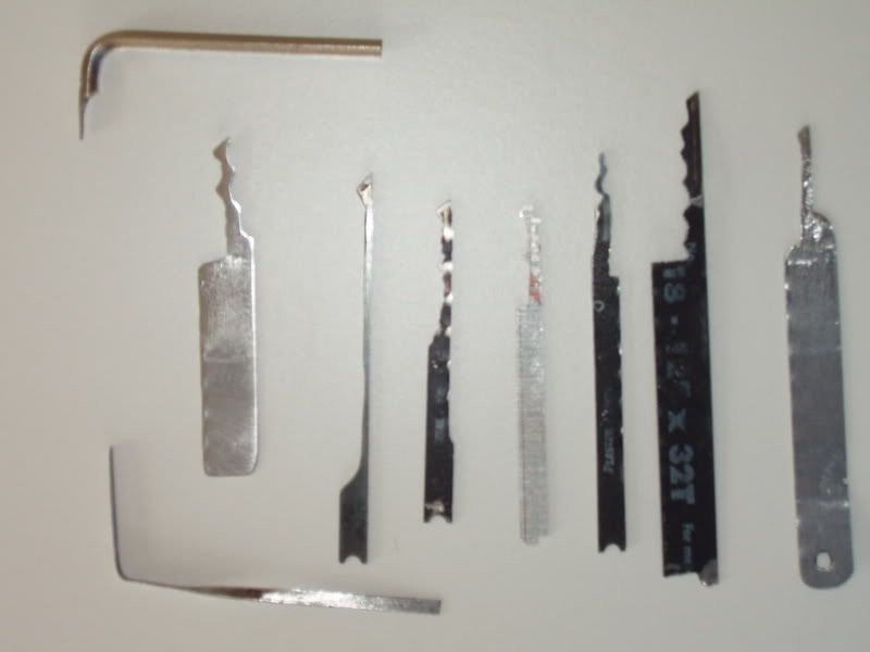

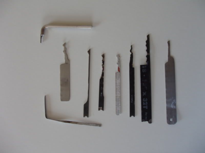

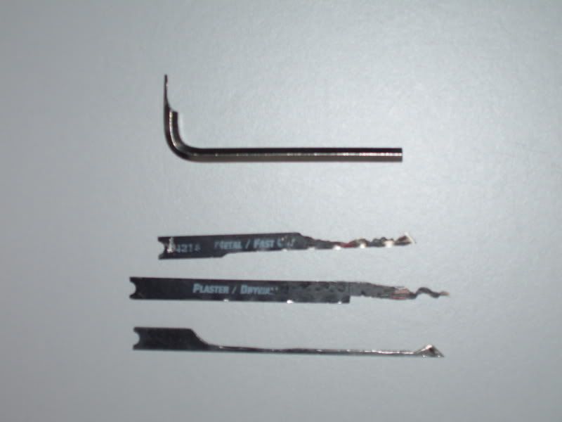

Postby falkman » 19 May 2007 13:57
helps me out, just picked up some streetsweper bristles, heres some pics of my picks...haha it rhymes...
Before:
http://i73.photobucket.com/albums/i226/ ... 060030.jpg
After:
http://i73.photobucket.com/albums/i226/ ... 100033.jpg
http://i73.photobucket.com/albums/i226/ ... 100032.jpg
Tell me what you think,
Falkman

Postby zeke79 » 19 May 2007 14:14
Falkman please dont take this the wrong way. Your picks need to basically be remade. The one diamond shaft is too thin for too long. It will likely break. The other picks, the shafts are too big and will disrupt pins while picking.
Have a look around the forums here for some templates or you can find some by clicking on the www icon in my profile.
Dont let this discourage you. Making picks is an art form. I just don't want you to think lockpicking is no fun using your tools when properly made or purchased tools will make picking much easier and more enjoyable.
Postby falkman » 19 May 2007 14:28
WAHHHHHHHHHHHHHHHHHHHHHHHHHHHHHH! :cry:
just kidding, yah, the one with the diamond surprisingly doesn't break, but i think ur right about the other ones.
