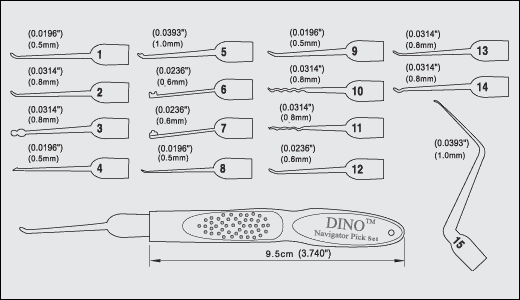

Postby Romstar » 22 Sep 2004 3:41
Take a good look at this illustration:
Of particular importance to these locks are picks 5, 6 and 7. This illustration is the Brockhage/Dino Navigator set.

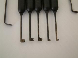

There are other pick sets that are dedicated specifically to these locks. Rogan make a prodct they market known as the secretary, also there is a pick set known as the Matador. I can't remember who made these though. They are pictured below.
The next set is made by Souber tools, and they are quite good as well.
I hope these help.

Postby Garrett » 22 Sep 2004 4:36
Very helpful, thanks!
