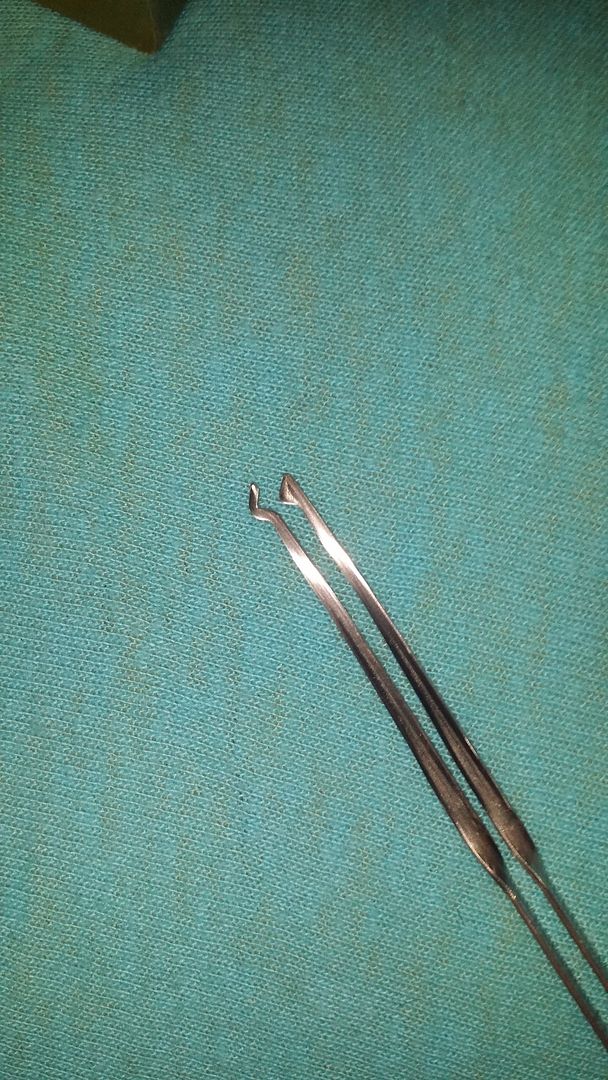

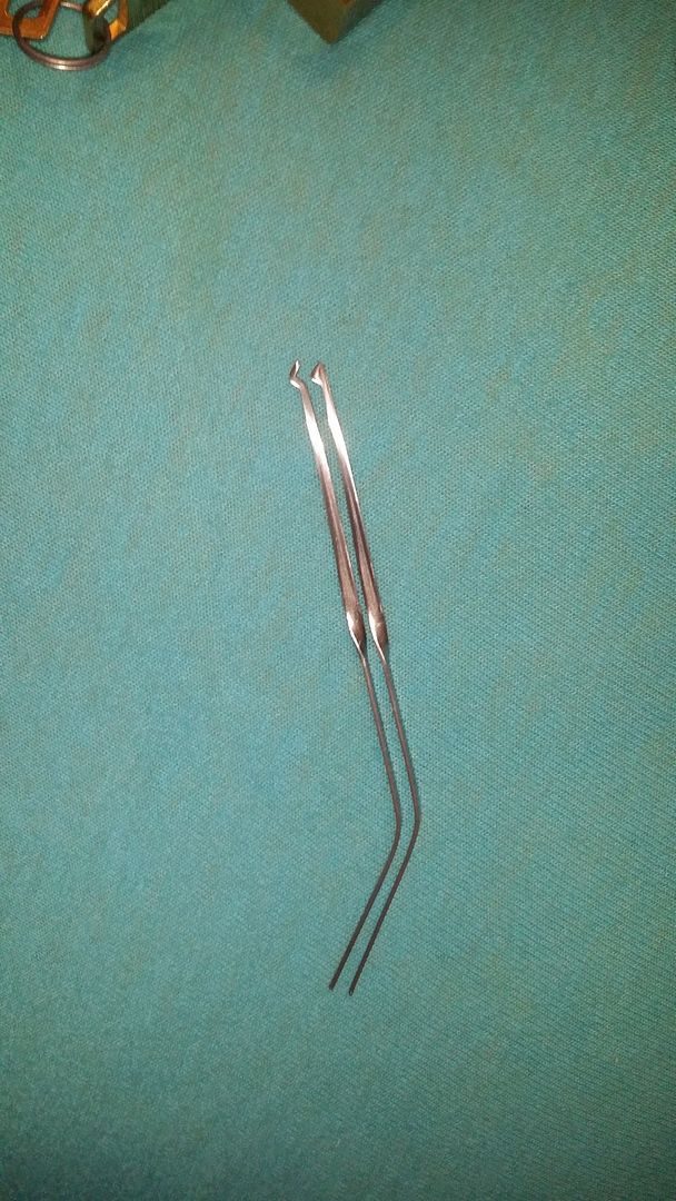

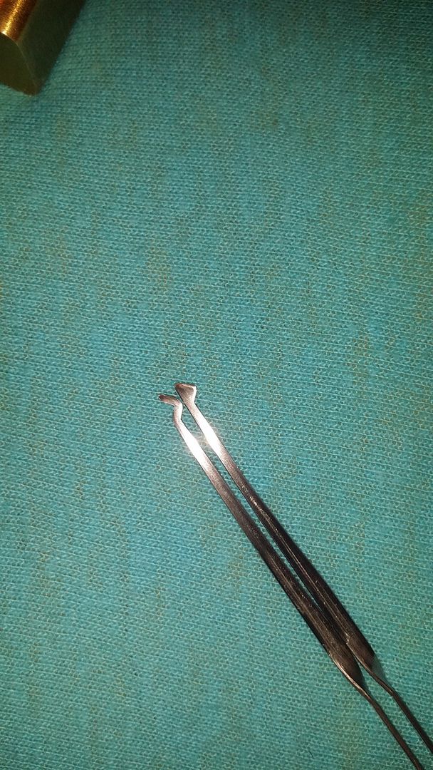

Made a couple picks from bristles picked up from Squelchtone.

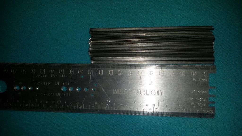

The absolute coolest ruler on the planet seen here is from MNPCTECH.com. It's got all sorts of fancy features, recommended product.

Mmmh I see some matte areas in the center of the picks... you need to buff them properly if you want to call them mirrors :twisted:
Just kidding, nice job :wink:
Re: Made some mirrors today.
Postby Comrade627 » 27 Mar 2015 3:48
femurat wrote:Mmmh I see some matte areas in the center of the picks... you need to buff them properly if you want to call them mirrors :twisted:
Y'know there IS a line that runs down them a good bit. It's deep in there too, hard to sand out. I feel like if I DO sand that far, I'll make them too thin. I'll have to try it sometime anyway.

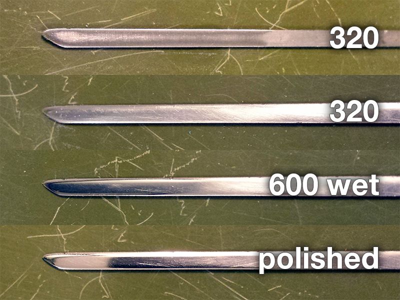

I've collected a bristle from the side of the road and sanded its tip. I'm going to post this to show my theory about the dark line in the center.
When you just start to sand, there is one line of patina that doesn't come off from the center of the bristle. That's due to how sanding works: it removes more material from the edges and creates this darker line in the center.
Start with 320 grit sandpaper. A stripe used like a rag is a good start. You can go any direction, but for better results try to work perpendicular to the pick. Or you may bend a piece in half between your thumb and index finger and work around the pick for a few minutes. Be careful not to modify the pick size too much, 320 grit sandpaper eats metal very quickly.
Then go on with 500 or 600 grit, bend the sandpaper in half, spit inside it, put it on the table and slide the pick back and forth, turning it upside down from time to time. You eventually get a very good finish.
If you work on the table or on a flat and hard surface, the dark line disappears easily. If you work it in your hands or on a soft surface, the borders are sanded a lot more than the center, and this line never disappears.
If you want something really like a mirror, a buffing wheel is all you need. Wear eye protection!
