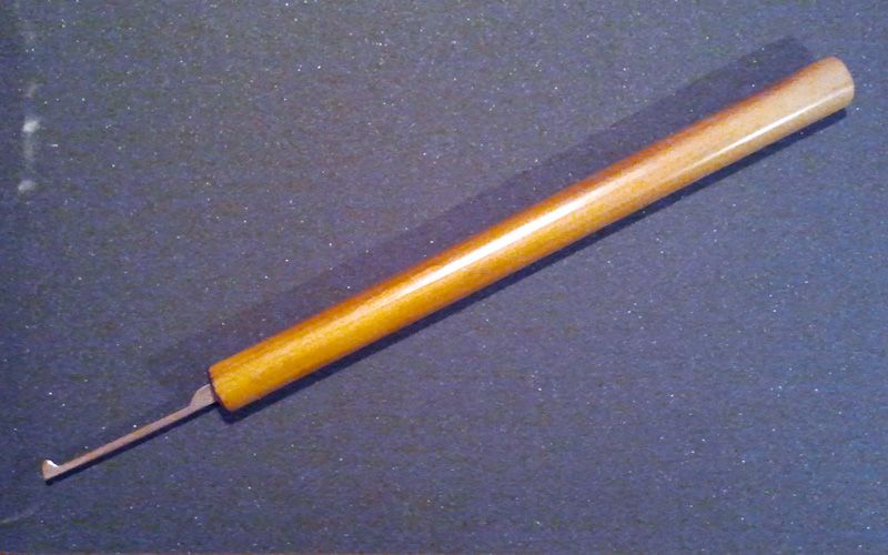

My new bamboo handles
Re: My new bamboo handles
Postby raimundo » 17 Sep 2011 11:40
Ratyoke also made that cover. and made it a lot.
thanks for showing the photos

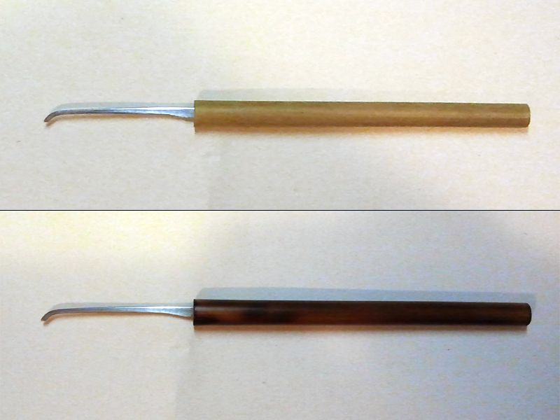

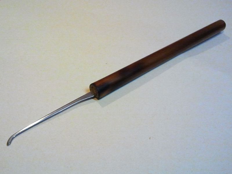

I'm working on a bamboo handled hook for my friend MacGnG1. I've made the pick with my wet grinder, so it didn't get heated at all. Then I carefully sanded it and then polished with a dremel felt and red paste. Now I need to find a nice piece of dried bamboo to fit it... ten I'll fire harden it. I'll keep you updated.
Postby femurat » 12 Oct 2012 10:17
Here you can see the handle before and after fire hardening, and the finished pick.

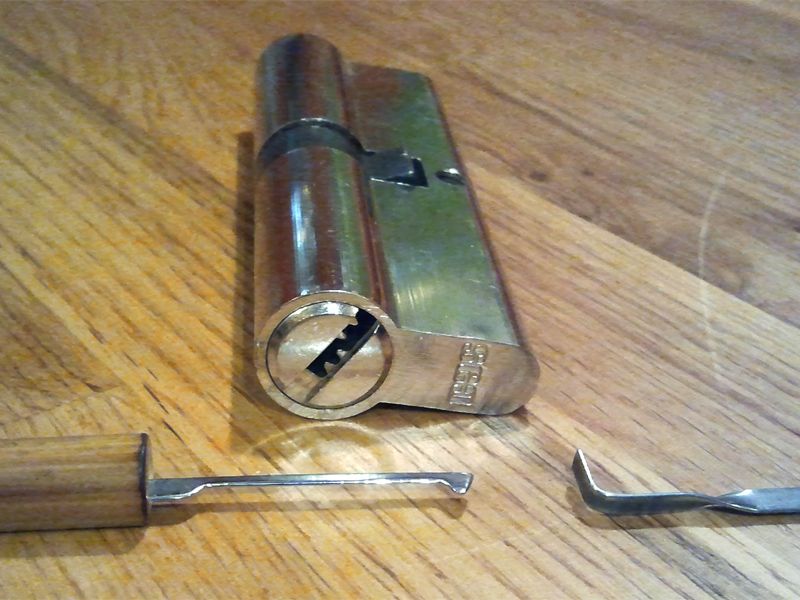

Postby femurat » 4 Dec 2012 9:19
I made a nice half diamond with a straight shaft for our friend Gordon. This is my favorite shape for dimple locks. The handle is a bit longer than usual, I think it's more comfortable this way.
First two pics are before and after fire hardening. Sorry for the bad pictures, my phone camera is't as good as it used to be after the firmware update. I tried different backgrounds but as you can see the result is not good. The handle is not that yellow, imagine it a little more brown.
Last picture was the pick test with a CAS 6 pins.

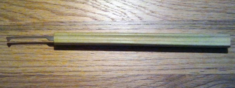

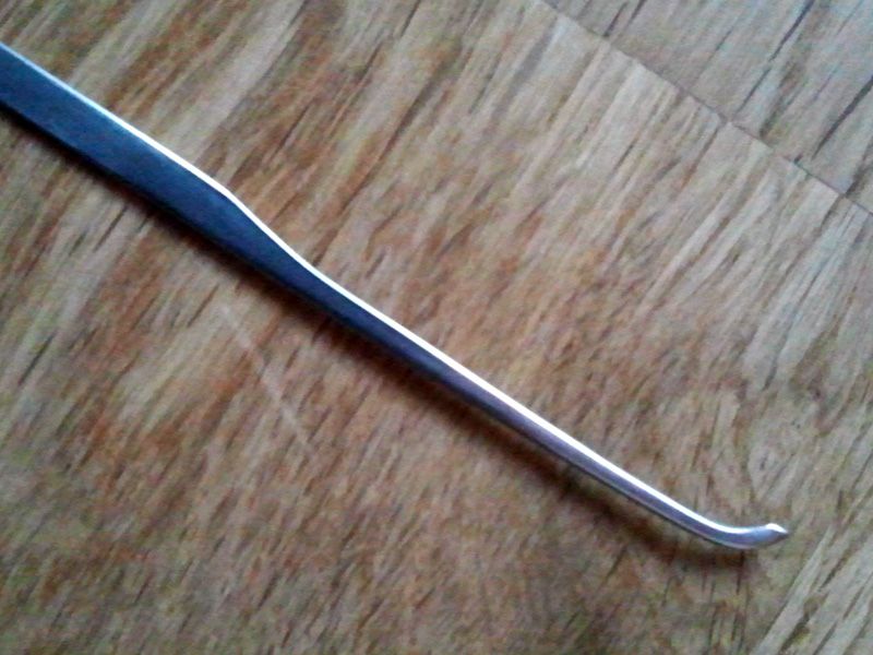

Postby femurat » 16 May 2016 4:48
I eyeball the size and shape of the picks I make, so every one is unique. I have my favorite pick and I decided to make a copy of it. Of course it's not exactly like its elder brother, but it reckon it very much. Here they are, the bigger one is the oldest.
Shaped, sanded and polished
Fitted to its handle
After fire hardening the color is darker
