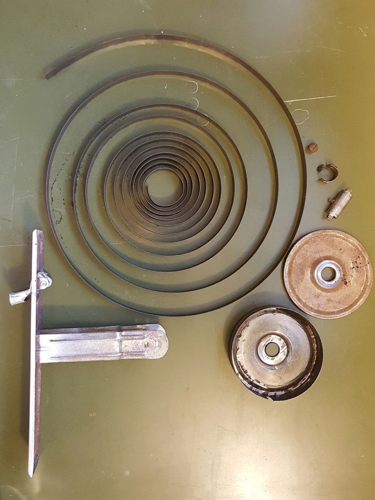

Postby femurat » 19 May 2016 4:03
Here's another idea. An old rolling shutter broke and I managed to save its spring. It's way too big for euro picks but should be just right for us ones.
Cheers :-)
