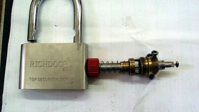

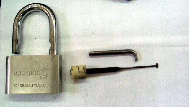

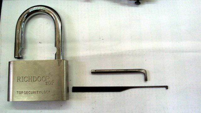

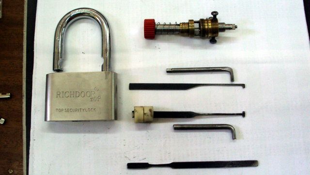

hi friends i was intrigue with these locks (disc detainer padlocks) and i found out lots of them, after i made my disc detainer picktools, and tried it one after the other..padlocks, that claims Top security locks, especially those that were made in china, were not , AT ALL.. top security lock..here are the 3 types i fabricated which all of each of this can open them. to those who wish to fabricate the most practical ones, which naterial can be easily found, (see video please)
note: the tensioned type wrenches are two types i fabricated. the concave type and the squretype. all of these works effectively
the Picktool i took it from a a plummer's clogged remover spring. its width is 5mm and thickness is approximately 1.5mm
here are the pictures and the video, on how i fabricated it. thanks for watching..and i hope it helps fellow locksmiths, if ever they
they want to do it diy.
