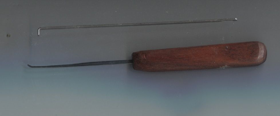

Postby apburner » 23 Jun 2017 15:45
Just picked my first Master #3 with the pick shown. Made them from windshield wiper inserts and the handle is rose wood I had laying around. Polished to 1000 grit.Image

Postby GWiens2001 » 23 Jun 2017 17:39
Nicely done, apburner. Like the fine, narrow neck on the pick - it will be good for high-low pins, allowing you to set pins further in the lock without disturbing the front ones. Anyway, it is satisfying picking a lock with picks you made yourself. :)
