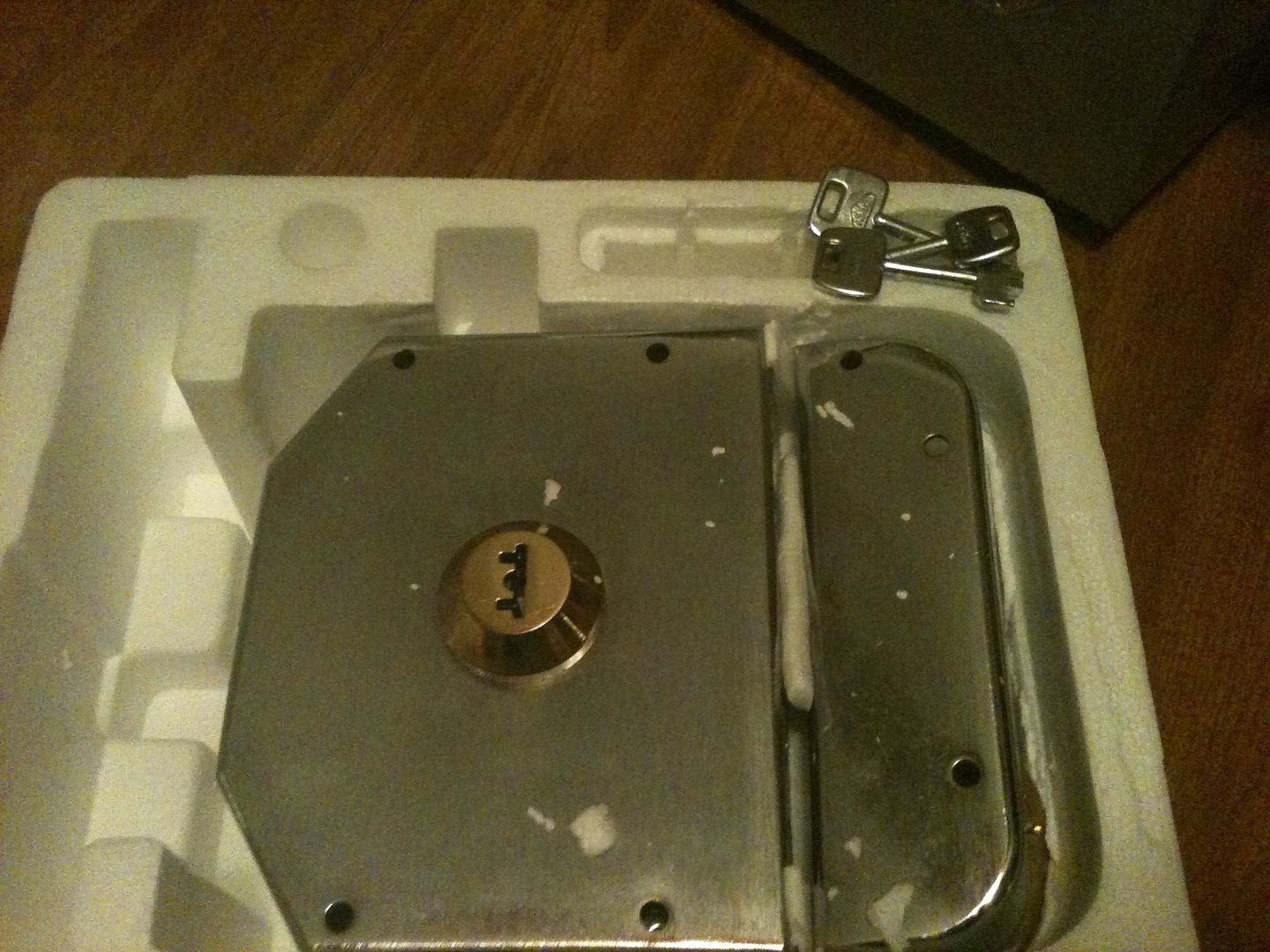

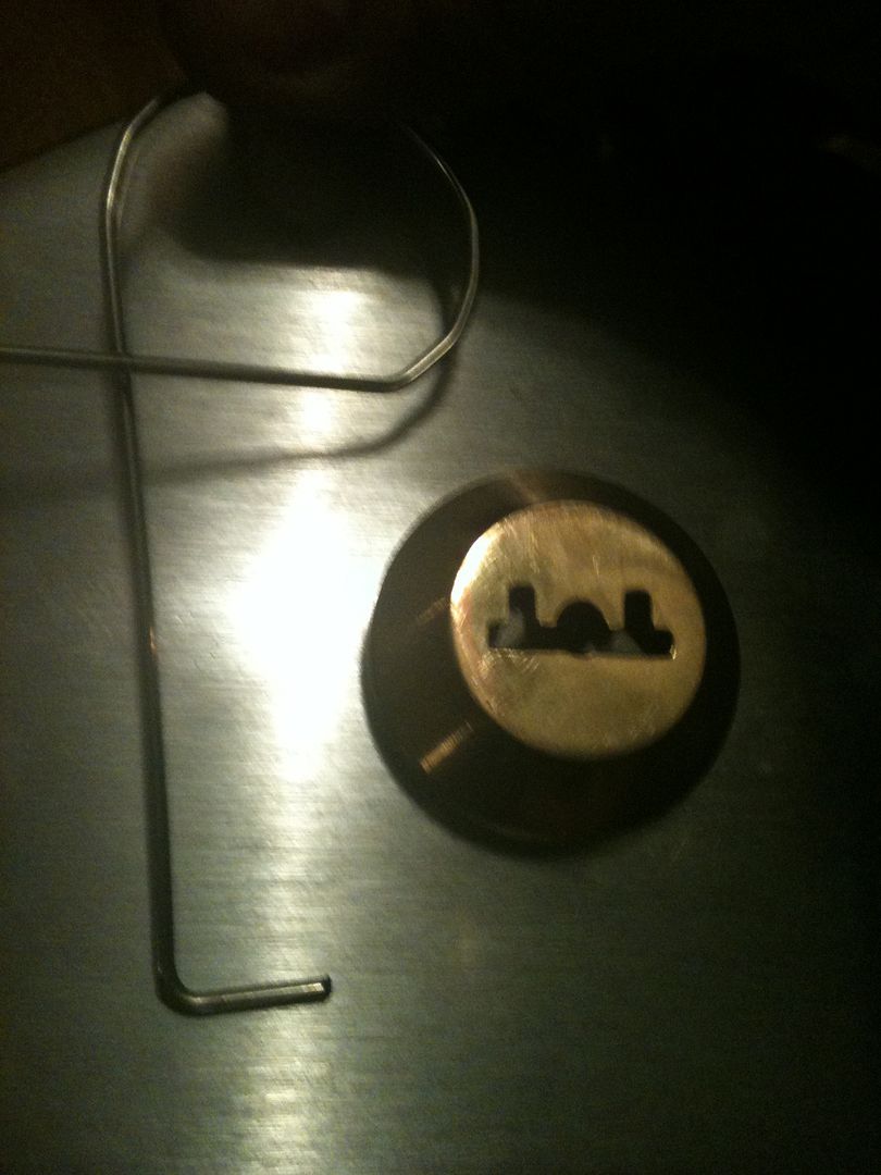

MSeifert beat me to it. Was going to guess this the Iseo Perfecta:
The box name matches the lock from the video:
I used a wire that is normally used to tension a lever lock and a straight poker to pick it. You can see the keyway is the same as the video.
Was thinking it could also be for a W-LOK, since the tensioner/pick made for me by Rai looks the same, but the W-LOK is a little bigger.
But the video is pretty clear.
