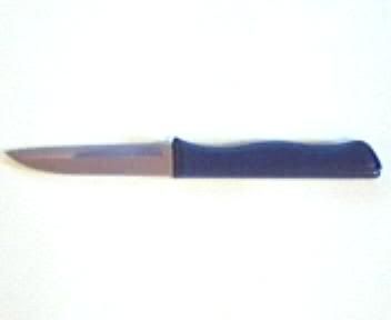

Wrenchman: That was the day I invented lockpicks. I remember it vividly. I was standing on the edge of my toilet hanging a clock, the porcelain was wet, I slipped, hit my head on the edge of the sink. And when I came to, I had a revelation, a picture, a picture in my head, a picture of this. This is what makes lockpicking possible.
Image Image
Can you see it ? Here is a vegetable/butter knife, with a very nice handle.
You just turn it in to any kind of pick you want :idea: :D
Slides right into the lock 8)

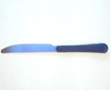

Proper butter knives are ok, filler/putty knifes are also a good source as well, table knives are to thick normally.

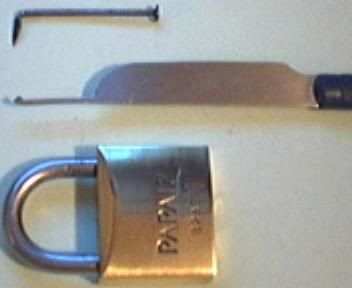

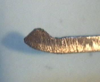

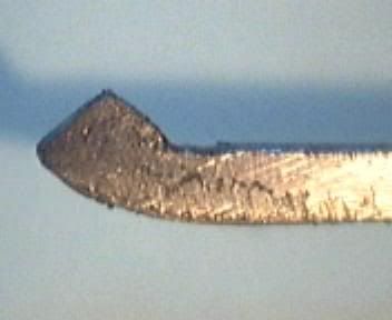

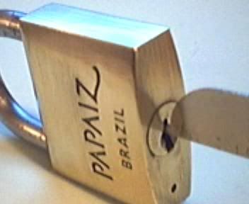

Image Image Image Image
The handle does´nt really work as supposed to, because you want your fingers to be close to the lock, but it´s there, so be it!
Well, you could make the pick close to the handle, but... This, gives you like three chances, should it break, or when you get tired of it, or even when your skills develop, and you can make a pro pick.
I made the pick with a sharp edge at first, and tryed it, but with no luck, then I rounded off the top, and now it´s much better, the lock opens in a sec.
If it is too thick, you can file gently on each side! (but it´s not)
