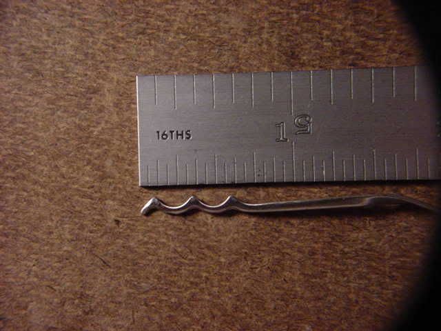

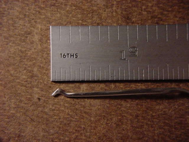

I saw earlier in this thread some people have asked for more exact dimentions of Ray's bogota picks. I PMed Ray for permission to post this link to a PDF document that I made. The document shows the dimentions of the bogota pick set displayed on varjeal's site that sells the picks.
Ray reminded me that not all pick sets are the same, because of the stock that is used, and the size of the cylinders that the picks are being made for.
Anyway, thank you Ray for these wonderful picks, and I look forward to working on a set of my own once I get my hands on some street sweeper bristles.
http://www.geocities.com/jmac875/Rays-B ... ntions.pdf
Let me know what you guys think.

Postby jmac875 » 6 Oct 2006 16:21
I believe that these are a set of Ray's smaller picks, what I would love is if anyone that has some of Ray's larger pick sets, to lay them down on a dark cloth, with a ruler that has 1/16" markings on it. You do not need to take multiple pictures, as I use the ruler that is laid down at the bottom to make the calculations graphically.
So if anyone can do this for me, I would be happy to take the time of measuring out the dimensions and posting another PDF.
By the way my brother-in-law is supposed to be dropping off 5-6 street sweeper bristles in a few hours, you know what I am doing tonight.....
Have a great weekend all.

They look a little rough, meaning I seen some rough edges and in some areas too much material has been taken away and that will play a big part in the stress factor.
Anyways, to help you and some others out I have taken pictures of the Bogotas I got from Ray and next to them I have put a ruler measuring in 1/16ths that you specified could help. Mine are slightly different from Ray's but you can find my pics in this same thread made from stainless.
Kaotik
Posts: 1200
Joined: 10 Jun 2006 13:38
Location: Texas, USA
Postby jmac875 » 9 Oct 2006 23:43
Kaotik,
You are the man! This is what i was looking for. I have some more of the stock from the inventory posts, and I was thinking about making a set of smaller picks, but did not have clear dimentions. I see what you mean about the rough edges and removal of too much material. I used the dremel and should not have. It looks like my best bet will be to bend, and grind down my stock to the correct thickness, and do all of the pick end work by hand file.
