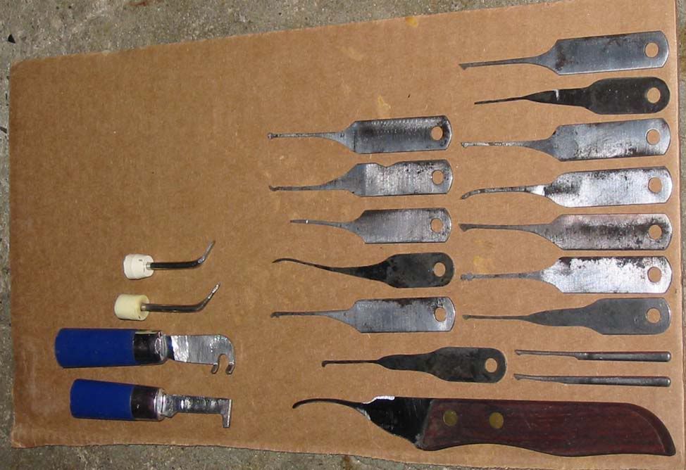

Almost all of my picks that I use now are made from feeler gauges. I just left them loose and use them individually. I have a nice little aluminum box I carry them in along with my tension wrenches. Two of my tension wrenches are made from those little pocket clip screwdrivers like you can pick up at the counter of auto parts stores, and two are made form cheap stainless steel steak knives. I also have a rake pick and a pick I modeled off of the peterson reach pick that are made from wooden handled steak knives.

Postby pinsetter » 16 Apr 2006 21:23
OK, here is the pic of the tools I've made from feeler gauges, glasses frames, and steak knives. They may be crude looking, but they do work wonderfully!

when you decide what thickness you like in feeler gauge material, remember, you can go to a machinists supply store and order the feeler gauges individually, in lenghs of one foot and half an inch wide. this way you can buy all the same thickness. I prefer anything from .022 to .028. I actually make 4 or more picks from a foot long feeler gauge. if you have a carbide tipped scribe, you can score a line, and rescore it and perhaps do the other side, then the feeler gauge will snap on the line like a soda cracker. if you are trying to break on with a single score line, do not make a sever angle of bend between the two pliers you are useing to snap it, just center the bend on the score, and tweak it about 15 degrees, then back and forth in the smallest wiggle, and it will break without causeing a lot of curl on the brokenedges.

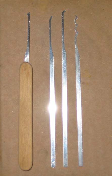

Postby pinsetter » 18 Apr 2006 20:15
Here are a couple of picks I've started making from wiper blade inserts.
I used a paint stirring paddle to make the handles for the one that has handles, and I'm going to make an entire handled set like this.
http://i53.photobucket.com/albums/g47/p ... picks2.jpg
I used epoxy to attach the handles, and it seems to work good.
Let me know what you think!

Postby Blink » 18 Apr 2006 20:29

Postby Blink » 18 Apr 2006 20:30
Blink wrote:Could anyone tell me how thick their wiper blade inserts are? Also, if anyone has some street sweeper bristles, I'd like to know how thick they are as well.
By the way pinsetter, those picks look great!

Postby pinsetter » 18 Apr 2006 20:47
I'm using Anco wiper blade inserts, and they are .030 thick
