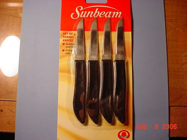

Postby Kaotik » 8 Aug 2006 14:45
I remember seeing those two materials mentioned somewhere on here...good advise none the less.
Also if anyone has the Pen Pick Set like this one:
http://i53.photobucket.com/albums/g55/K ... ickSet.jpg
You can also use the stainless blades from the small paring knives with the plastic handles for making the replacement blade if one breaks or gets lost.
Like these:
http://i53.photobucket.com/albums/g55/K ... Knives.jpg

Postby unbreakable » 8 Aug 2006 14:50
Kaotik wrote:I remember seeing those two materials mentioned somewhere on here...good advise none the less.
Like these:
That is one awesome looking pen pick!! :D :D
So you made the pick bits yourself? They look excellent, nice curves, even tangs.
