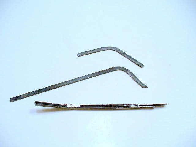

Postby Spossum » 29 Dec 2006 18:14
Hi Kaotic,
I was out practicing with some scrap bristles today. I got pretty good at making the "Kaotic Curve". I hope you don't mind if I call it that. I did better than I expected at welding them too. I am not a good welder, all I have is an arc welder. But after I grind it down and hide it under some shrink wrap I think it might be OK. Let me know what you think. I may be able to make one of your tension wrenches this weekend.

Postby Kaotik » 30 Dec 2006 14:43
Spossum Excellent! Glad to see someone giving it a try, and the welds don't look bad at all. After I weld I just use my Dremel and a medium-course grinding wheel to even out the profile, after shrink wrapping them you can't tell at all.
"Kaotik Curve" That's cool, I like it. No worries about the name, it happens.
