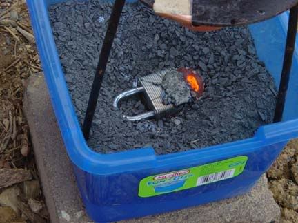

Postby Chucklz » 6 Apr 2007 14:38
Did someone say thermite?
