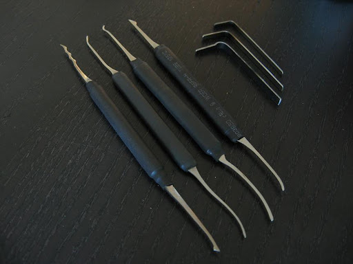

Postby Everett » 21 Jul 2008 17:07
The oil and transmission fluid dipsticks from cars make very good picks. I've tried making them from anything I can find and dip sticks are by far the best. The most suitable ones come from Ford cars. Also, I've made a few picks from titanium tent stakes from REI. They work well, and titanium stuff is just cool. Here's a few of my homemade picks--three from dip sticks and one from titanium tent stake. I still make the wrenches from wiper inserts, but I'll never go back to them for the picks.
Image[/img]

Postby E1001 » 21 Jul 2008 18:24
Everett wrote:The oil and transmission fluid dipsticks from cars make very good picks. I've tried making them from anything I can find and dip sticks are by far the best. The most suitable ones come from Ford cars. Also, I've made a few picks from titanium tent stakes from REI. They work well, and titanium stuff is just cool. Here's a few of my homemade picks--three from dip sticks and one from titanium tent stake. I still make the wrenches from wiper inserts, but I'll never go back to them for the picks.
Image[/img]
Yea I have a dipstick I'm gonna try out too. I think I'm just going to try to experiment on my own with all sorts of different materials, and find out which one works the best for me.
