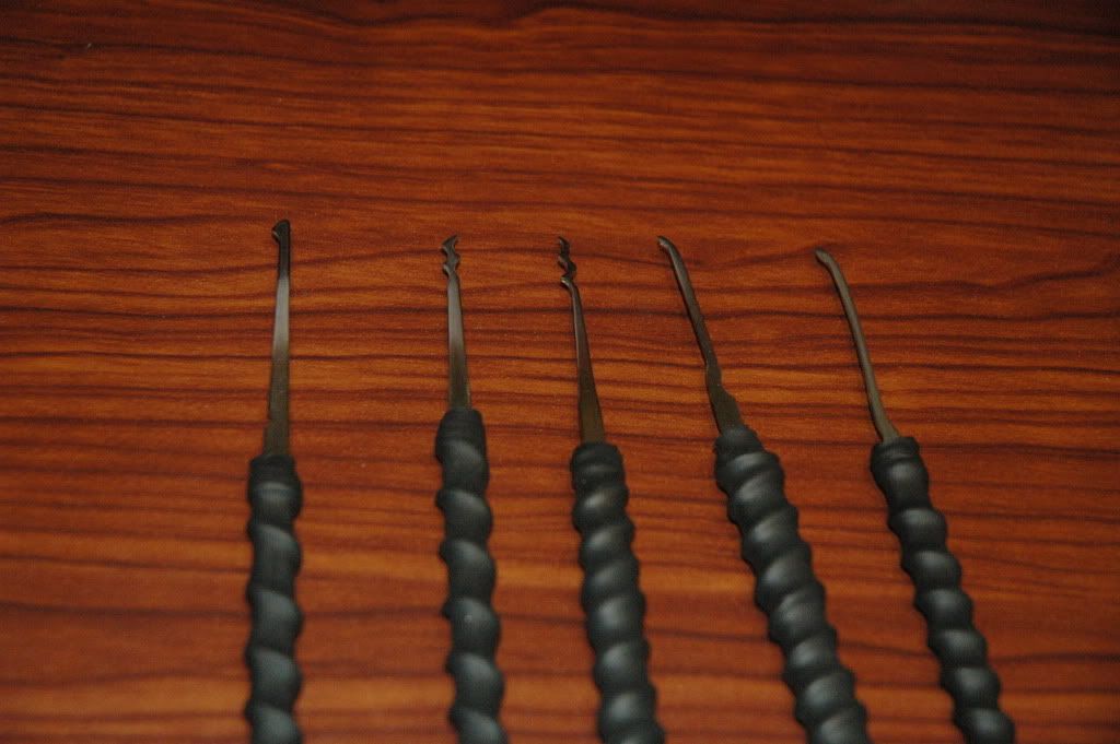

Here it is. I used some soft craft wood under the heatshrink so the wire would press into it and not slide. Then wrapped it to tight on the first pass, so it still isn't 100% uniform :? Hopefully I'll have some ToolyMcgee originals up soon that you can ripp off.

Don't need heat shrink on top. I used soft pine to build up the handle, sanded round so the tang was exposed, heat shrink, then tightly wrapped the wire. It is pressed into the wood. Otherwise I would have fixed that wandering coil. Even if I did need the shrink, I need the green more. :) Thanks for advice though.

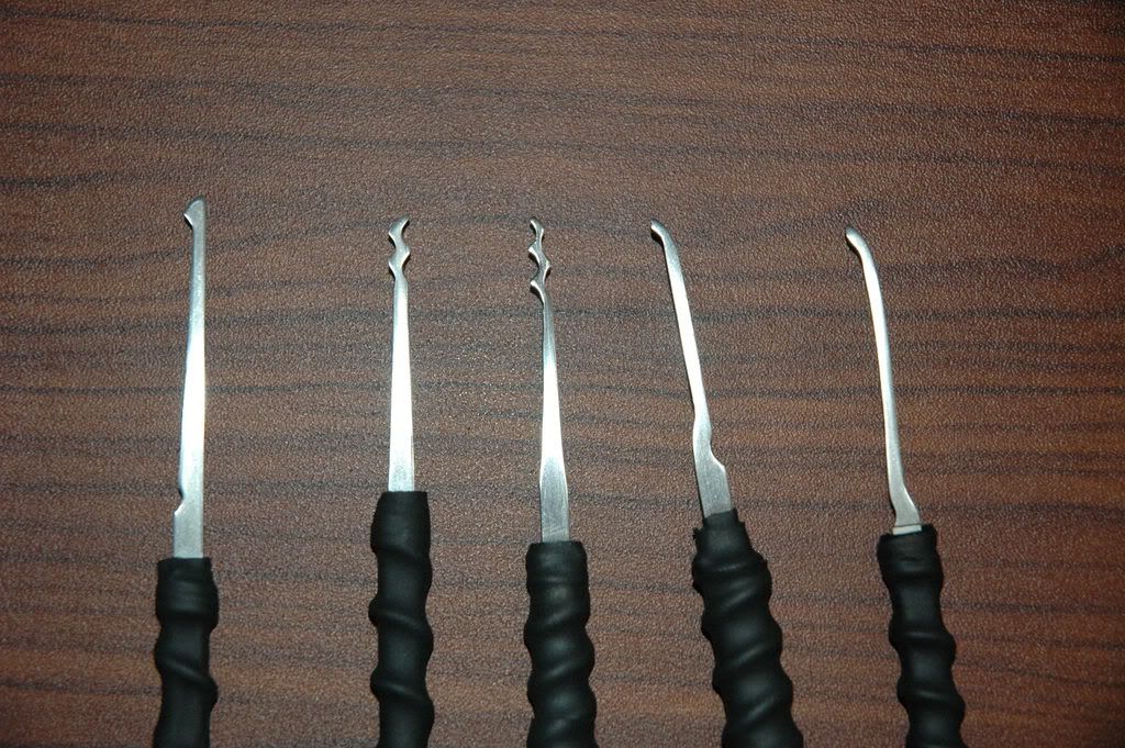

I love the little bit cut into the hook with a round file... I saw that in LN21's thread... and wanted to do it myself >=D
Haven't tried yet... but why is it done? for looks or functionality?

I do it for looks but I also believe it will relieve some of the stress on the pick. Plus it's a good gauge to let me know if I'm thinning the pick out to much.
