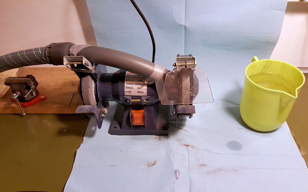

So after many years of service my wet grinder broke. The bearings supports broke. They're made of poor quality cast metal, so there was no way to repair the grinder and I had to throw it away.
I started using my other grinder and was very angry because it makes a mess. Dust goes everywhere. I have to vacuum clean all the room after I'm done... so inspired by some famous woodworkers I improvised a dust collection system :lol:
The need to keep the metal cool remains, so I had to dip it in water every now and then. That's pretty annoying.
Apart from that, it really made a difference, since almost all the dust got caught by the vacuum cleaner.
Now that I've seen that it works, I may make something better than some electrical tape.

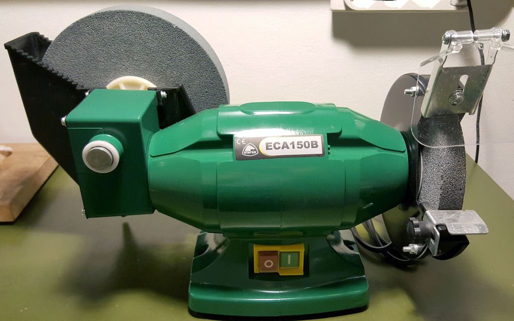

Here is my new wet and dry grinder. It's bigger than the old one and works quite well. The wet disk wobbles a little but I was not able to fix it by loosening the bolt, rotating the disk and tightening it again a few times. I'll keep it this way, it's not that bad. It works better than the old one.
I'll make an attachment for the vacuum cleaner on the dry side. I may use it for the gross shaping of the blank, before passing to the dry disk for refining it.
I've already made a set consisting of two picks and two tension wrenches with it.

That is a nice looking machine! How does the wet grinder part work without flinging oil/water everywhere?

The wet disk spins slowly so water doesn't go everywhere. It removes material very slowly and gives me good control of the process.
Keep in mind that I mainly use street cleaning bristles. When I use hacksaw blades I use the dry disk of the grinder or a cutoff wheel on a dremel, otherwise it would take forever to grind them down.

Oh, that makes sense. For some reason the thought of it moving slow enough to not make a huge mess never occurred to me.
