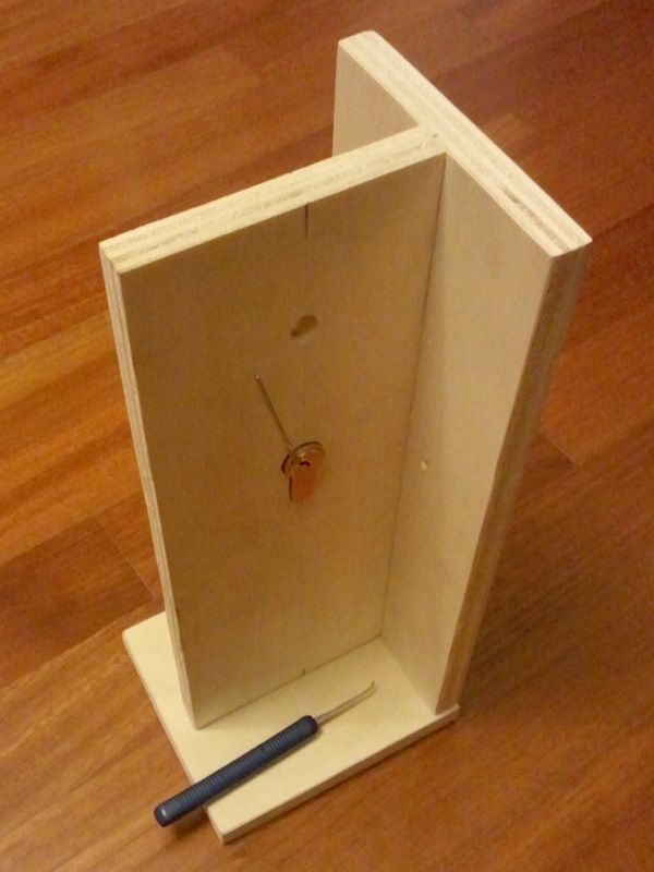

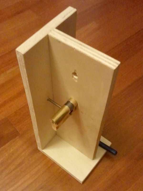

I recently saw a couple of posts asking info about a training station, so I dig out this thread and was on the point of linking it as an answer... but then I noticed I've never uploaded the pictures of the finished station. Well, actually the station is not finished, since I've never mounted a knob to complete it, but I'm going to do it in the next future :) Here is it.
As you can see I've added a screw to hold the cylinder in place. I made the hole on both sides, so the station is usable from both sides.
I simply put it on the table and play. It's simple but useful: the distance between the lock and the "door-frame" is typical so I can test a wrench to cut its handle to size. Even the height of the lock is typical, when the station is on the table, so I COULD practice a "true" lockout situation. But since I'm lazy I prefer to sit down on my chair and play with my arms comfortably resting on the table :mrgreen:

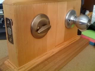

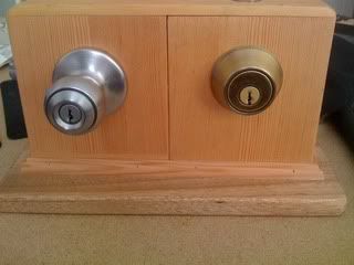

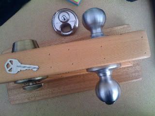

Couple of weeks late, but I figured things like this are worth sharing. I mentioned to my friend that I wanted something with a couple of holes for locks to practice on and he told me he could whip something up in no time. I forgot that he works at a lumber yard/door company! Good guy to have around :D.
Here's what he made for me:
Front
Side/back
Don't worry about that BiC box, it's for mechanical pencils :P
Top
Here is a link to ITS that inspired me to make one of these: http://www.itstactical.com/2010/10/29/h ... ctice-set/
Nothing fancy unlike squelchtone's gorgeous set up (color me jealous!), but it works. Down the road maybe I'll make something pretty.

Re: how to build a "training station"?
Postby IndigoChild » 13 Feb 2013 19:10
This may be an odd question but how long are your tension wrenches if the frame gets in the way. Granted I have long tensors but I usually move the tensor to the side the frame isnt on. But I still cant imagine it getting in the way.
"How does it work?"
IndigoChild
Posts: 236
Joined: 1 Feb 2013 13:50
Postby femurat » 14 Feb 2013 4:20
Hey IndigoChild, that's exactly the purpose of the training station: to simulate a real life picking situation. Hence the "door frame" very close to the lock. This allows me to cut the wrench long enough to turn the plug, but short enough to rotate the plug one full turn.
Since I prefer long and stiff wrenches, I usually pick the lock with it and then remove it and turn the plug with a shorter one.
