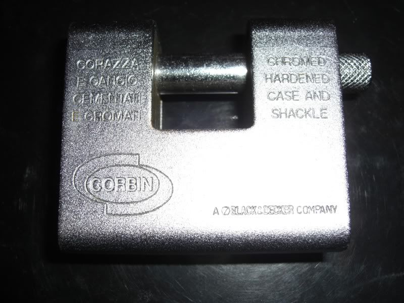

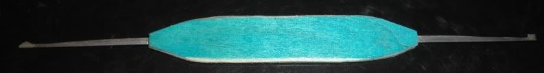

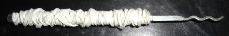

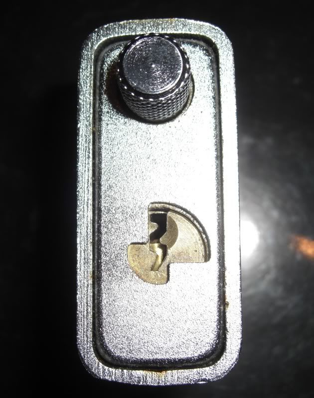

Postby rontgens » 8 Mar 2010 14:17
Here's a couple of picks I've made recently. A double ended one Diamond and just the square end that's sometimes left on wiper blades. I made the handle by gluing together some lollipop sticks and filing them down. And a rake of some description, which is really small and the handle is more wiper blade insert glued together and bound with elastic bands. The Diamond works well on a troublesome Corbin padlock I have.
http://i9.photobucket.com/albums/a68/nothing_studios/Corbin2.jpg
http://i9.photobucket.com/albums/a68/nothing_studios/Corbin1.jpg
p.s sorry of the pics are too big.
