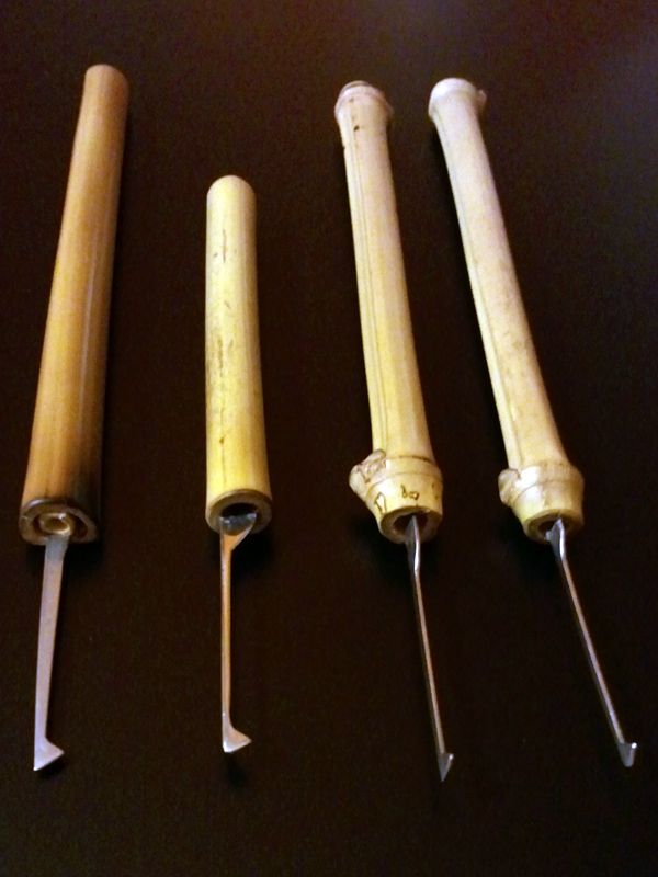

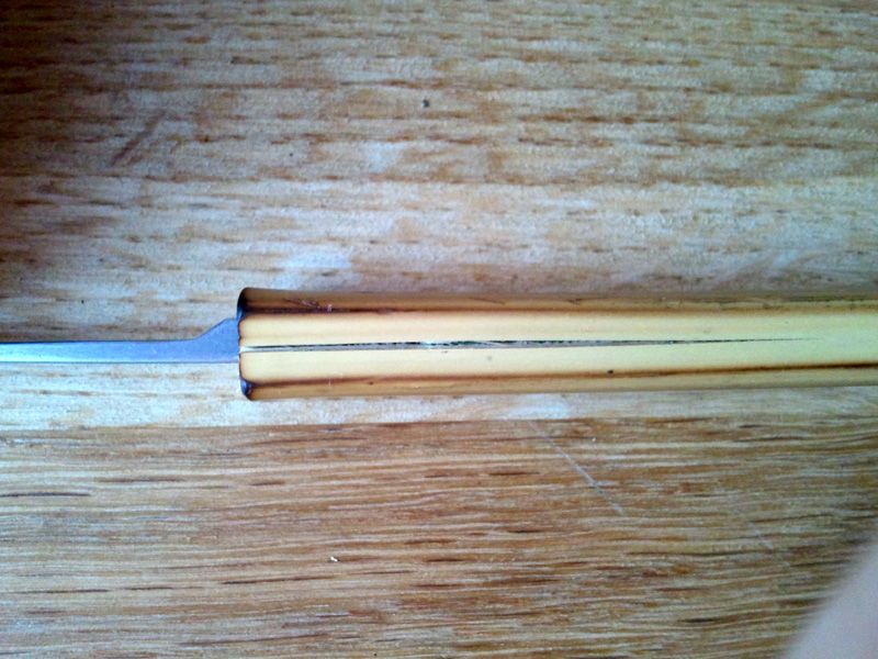

I fire hardened the handle of my last pick. You can see the green colour of a piece of the same handle I cut before the treatment.
I used a butane torch to quickly heat the handle while I was holding the pick from the tip. Every now and then I put the torch down to sweep the handle with a cotton rag and some bees wax. This is intended to clean the bamboo from the sugar that comes out during the fire treatment.
I don't know if my process was 100% correct, but as far as I can tell from seeing some video tutorials and reading some explanations on how to fire treat bamboo I got a very good result!
As you can see in the second picture, the older handles are lighter. I fire treat them too but I was too worried to burn them, so I moved the torch faster and let them absorb less heat. That's why they're more yellow than brown. Well, actually in that picture they look white but in reality they're light brown.

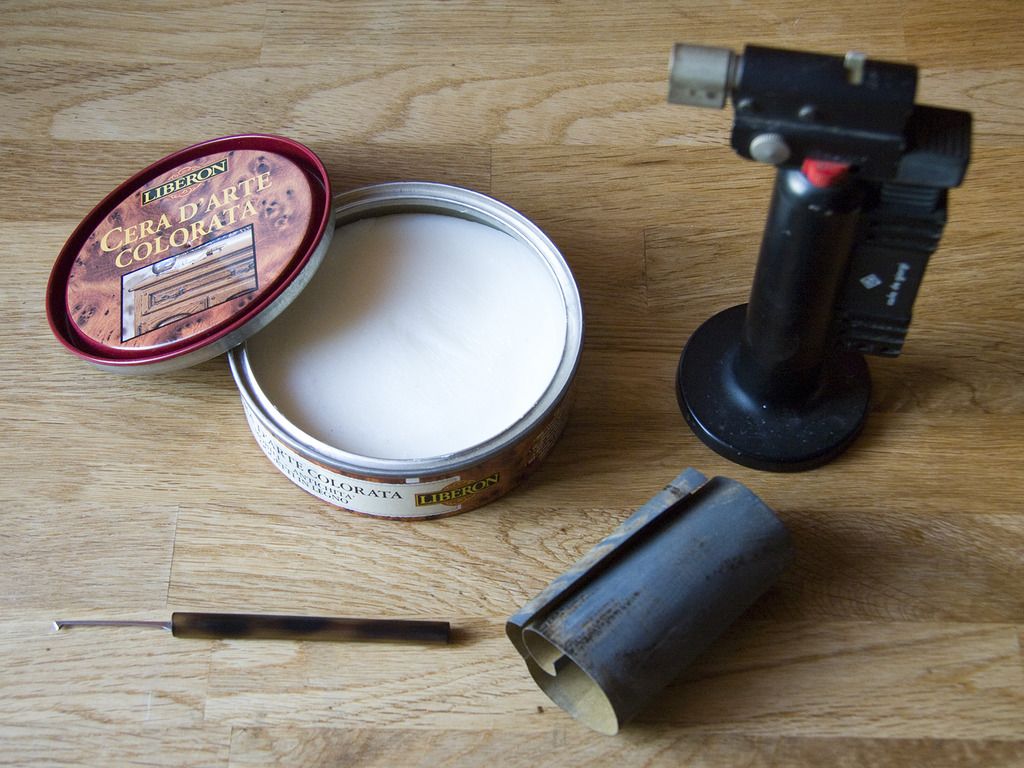

Postby femurat » 7 Apr 2011 9:24

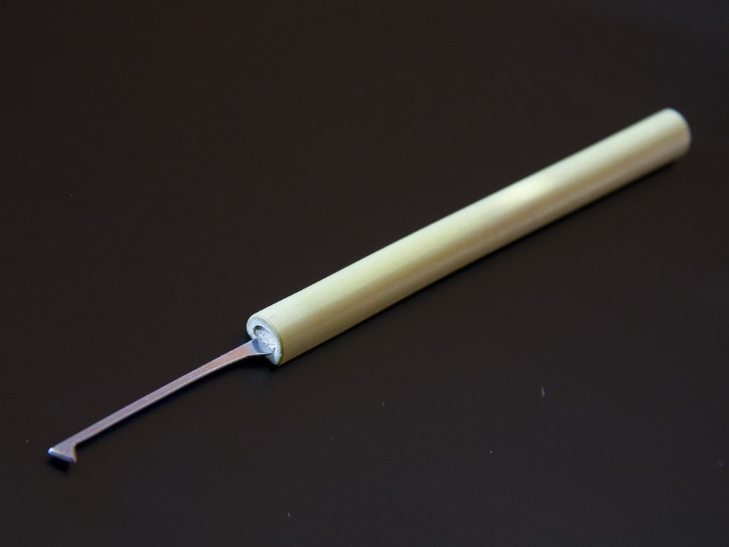

I made a custom pick for our friend Squelch. I designed it for ISEO R6 dimple locks. I tested it during the process, and since its shaft is a bit longer than usual, it works very well on MTL 7x7 also. These half diamonds with 2 angled corners are supposed to easily slide under the pins, and to lift them by rotating the pick. You hold it like a pen.
The first and third pictures show the pick before and after the fire treatment. As you can see it's a lot darker in the end.
In the second picture you can see the torch I used to fire harden the handle. I run the flame back and forth, while I keep the pick from the tip and slowly rotate it. Every few seconds I put down the torch and sweep the bamboo with a rag soaked with bees wax.
This is a very important part of the process since the wax penetrate into the dried bamboo and prevent it from splitting.
A cotton rag should be enough, but at the end of the process I had to use a piece of sandpaper (1000 grit) to remove the debris.
It's a quite difficult process since you can burn the thin bamboo. But it's supposed to harden it so it worth the effort.
I think these bamboo handles will need some bees wax from time to time.

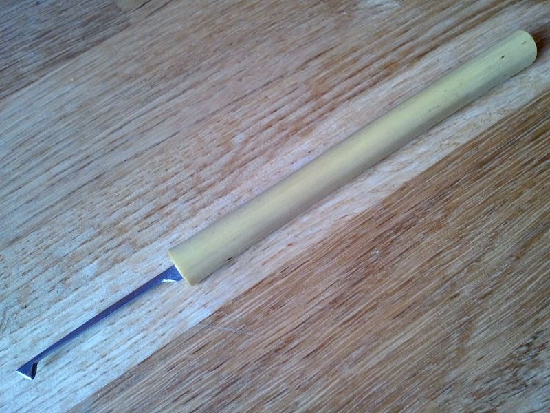

Re: My new bamboo handles
Postby femurat » 8 Apr 2011 3:32
Thanks for the compliments Squelch 8)

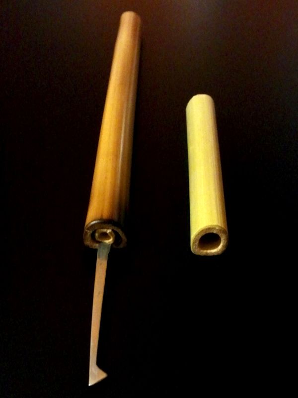

I was making another bamboo handle, but unfortunately I made a mistake.
I don't use any glue to assemble the pick. I prepare the internal rod to size in a D shape. Then I push hard to fit the pick and the rod in the bamboo hole. I always have to test many times the dimension, and I reduce more and more the rod size with a cutter until it's a bit bigger than needed. Then I find the right size by sanding it down. You have to get a feel for this. If the rod is too small the pick will have some play and eventually fall out. So the aim is to find the biggest size that fits.
It's clear that this time I used a too big rod. There was too much tension so while I was fire treating the handle it cracked :cry:
I'm really disappointed, I was close to the end of the process... now I have to start again.
Hope somebody will learn from this mistake.

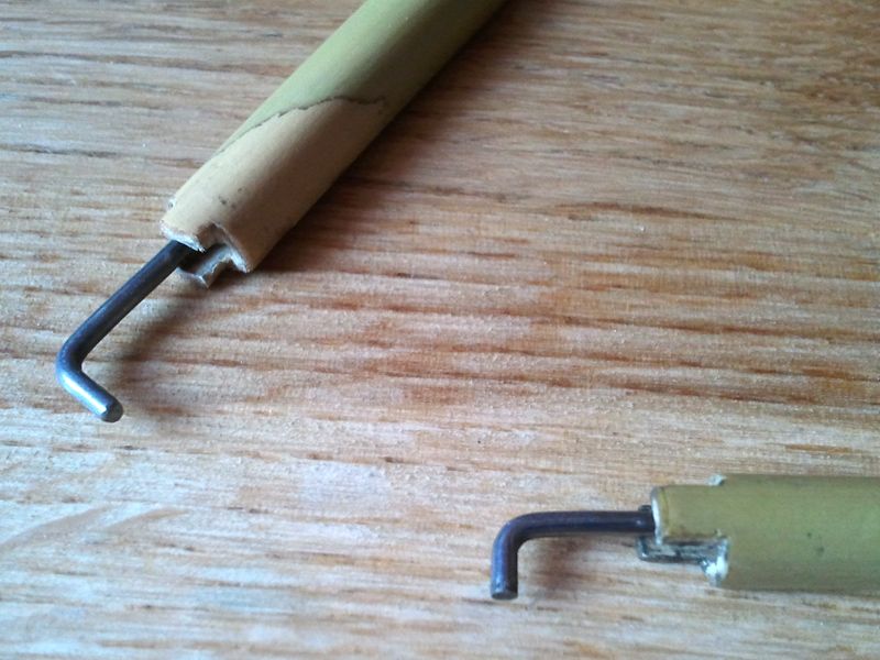

Postby femurat » 13 May 2011 3:49

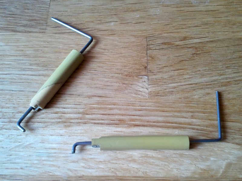

I found a disk detainer lock lying around and since Jaakko's tool didn't fit, I decided to make one. I ended up making two :mrgreen:
I'm not going to discuss disk detainer locks in the open forum, I'm just showing the tools I made.
As you can see the wrenches have different length, the longer one engages two disks. The pick tip has not the ideal shape, but was the quickest I was able to make. I know I should have made it better, for example like a T. In fact I wasn't able to pick that lock. Maybe because it needs tension from the bottom disk, maybe because my tool was inadequate.
I was surprised by the strength of the two little pieces of bamboo, so small but able to turn the disks.

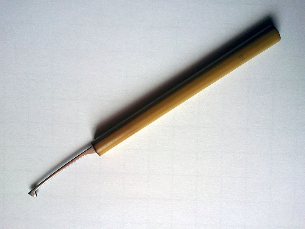

Postby femurat » 4 Jun 2011 4:31
I made this pick for my friend Raymond. I had the pick ready one month ago, but it took me a while to find the right size handle. I prefer to avoid glue, so my picks are held by friction. That's why the two bamboo pieces must be the right size.
Postby femurat » 8 Jun 2011 7:00
I decided to put a drop of super-glue to keep this handle attached to the pick. I know, I know, I said it was tight even without glue, but after a few picking tests it was starting to move a little... now is super tight!
