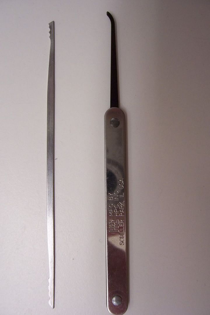

This pick was made using the above method. to grind the tip side of the tang i used the other side of the grinding wheel.
It was sanded using 300 grit sandpaper, the design is a fer sawtooth kinf rakes.

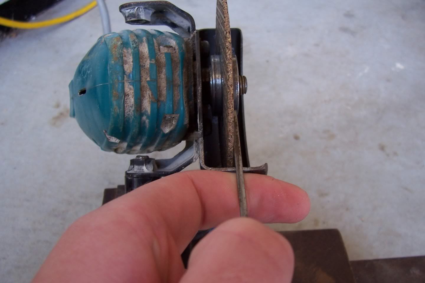

This is the Angle grinder set up in a vice ready to be used to make picks:
This is the finished pic yet to be sanded:

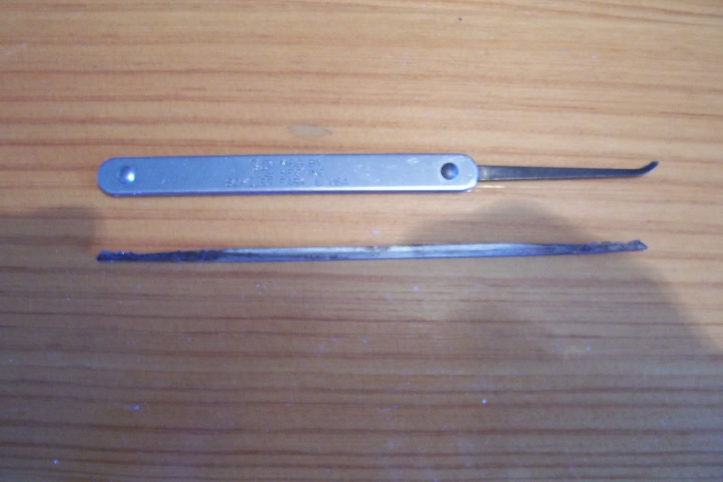

This is the end result, next to a HPC hook:
