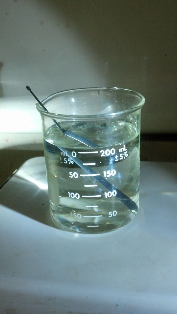

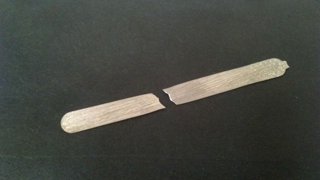

Good news. Our tensile tester at work was more than able to break the pick.
Here it is;
It required 5.4467 KN or 1224.47 pounds of force to break. It deformed a little before breaking.
Now, the bad news.
I put the previously dipped pick in a cylinder of acid in order to reduce it. However, the increase in surface area submerged in acid caused a greatly increased reaction from the acid. Before I knew what was happening the acid had boiled over; eating a leather glove, an aluminum bottle of lubricant and a box.
It destroyed the pick while it was at it. I’ll have to start over.

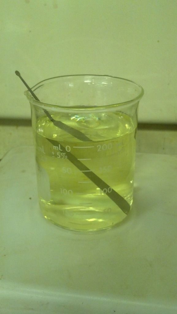

Well, thanks to the renewed interest I found the drive to move on. And boredom at work...
I just grabbed one of the last .0197 picks that I don't feel i'll use much.
So I threw it in.

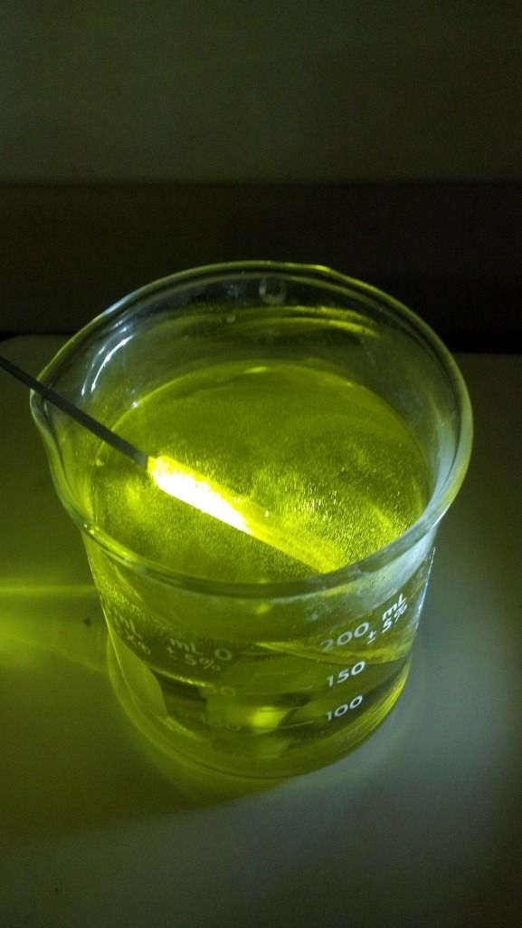

I used an agitator to try to get a nice even surface on the pick. I never remember which way to hold my phone so the video is sideways, sorry.
This is just a cool picture.
