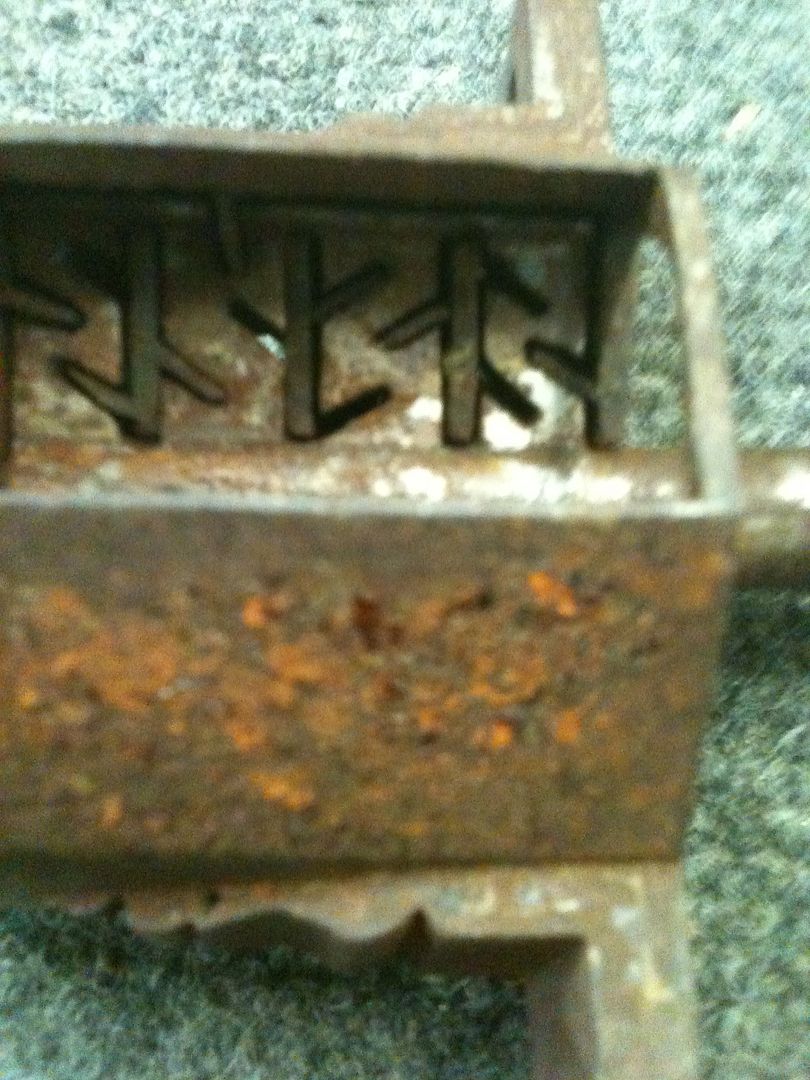

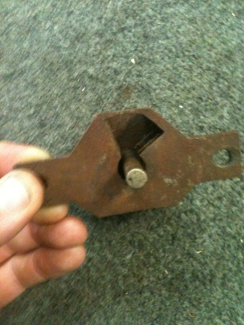

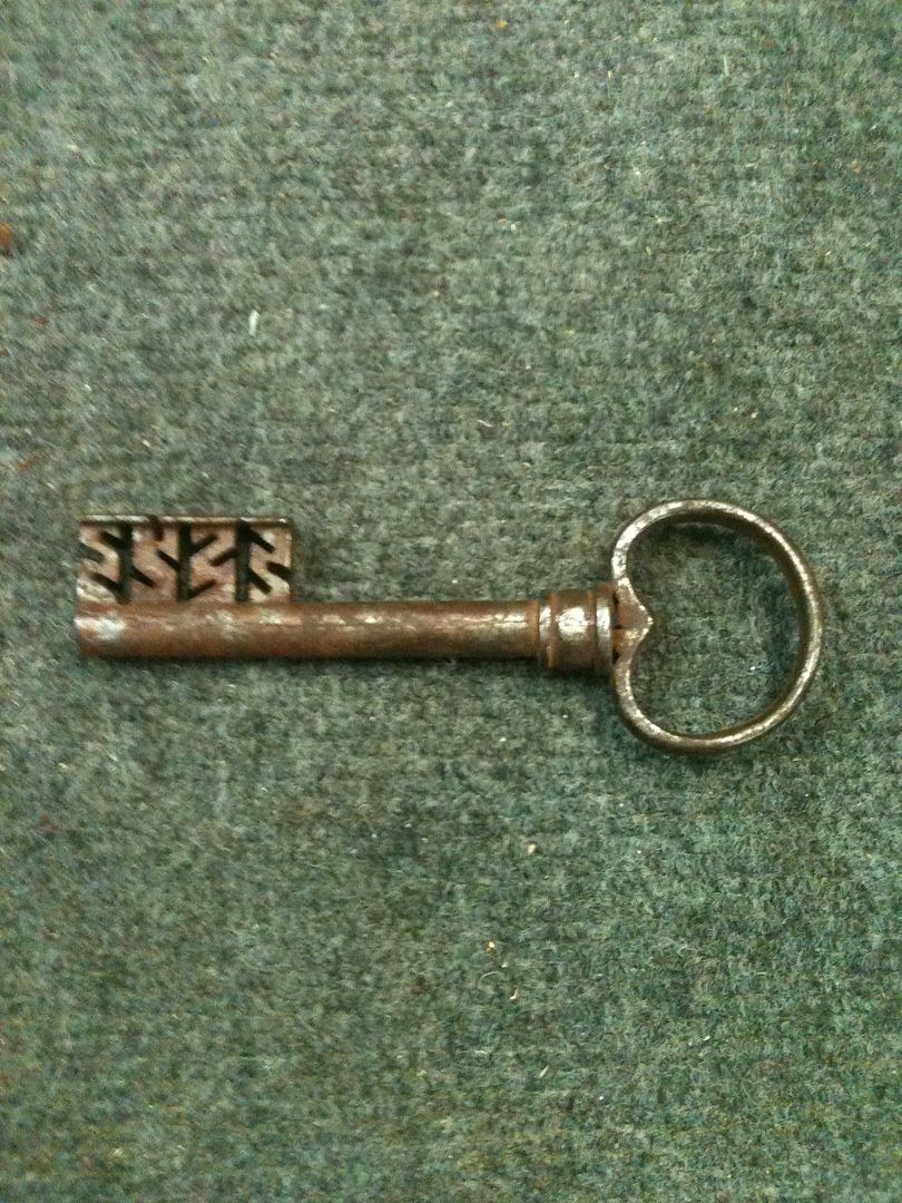

Postby YouLuckyFox » 13 Jul 2013 23:39
Oh my gosh, thanks for the wake-up call Gordon! Have some carried over quasi-antiques fitted with locks from my stay in Europe, might want to give a crack at these, but am unsure what kind of lock they are, any ideas? I couldn't agree more with Gordon's signature, I know a confident amount about some things, but when I go to older locking mechanisms, I feel like a dolt. Are they all just barrel keys I can use an L-shaped bar on?
Sorry to photobomb the thread, but I felt like this would be better than starting a new one.

Postby YouLuckyFox » 13 Jul 2013 23:40
Note: I only have the key to one, it'd be fun to make the other two, but I'd like to get good at picking them first!
