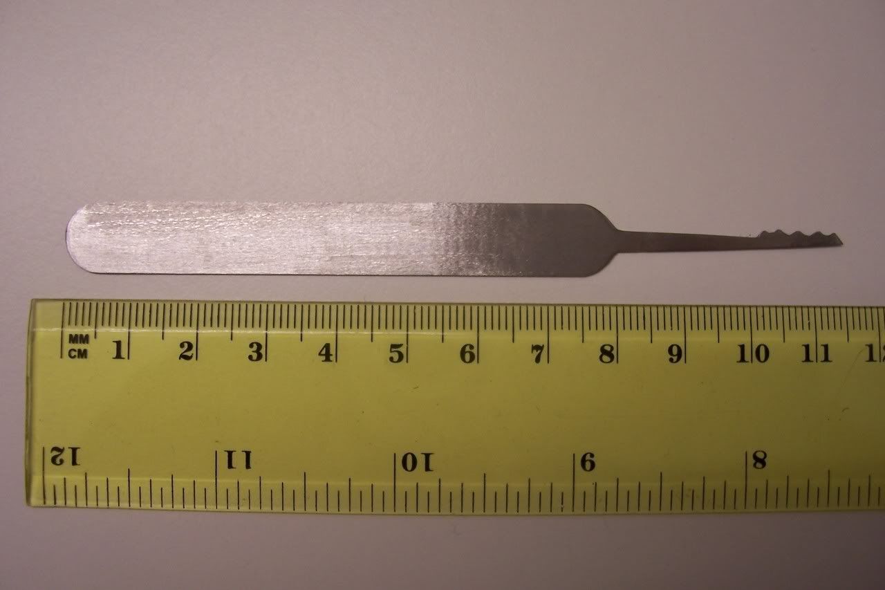

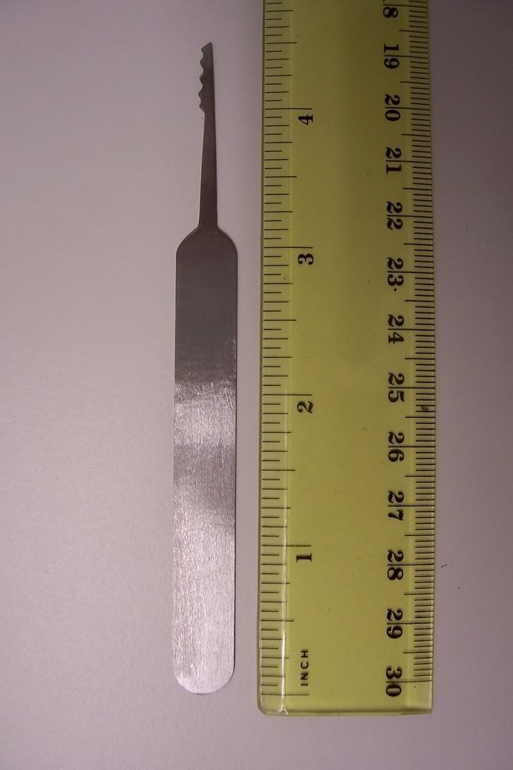

well out of boredom i started making a new pickset to rival people suck as Pick_maker and various others.
My first pick in the set was made using an angle grinder and dremel tool.
the sawtooth rake::: in centimetres
the sawtooth rake::: in inches

Postby Romstar » 14 Jan 2005 3:00
Very, very nice work.
Can't wait to see the rest. Keep it up.

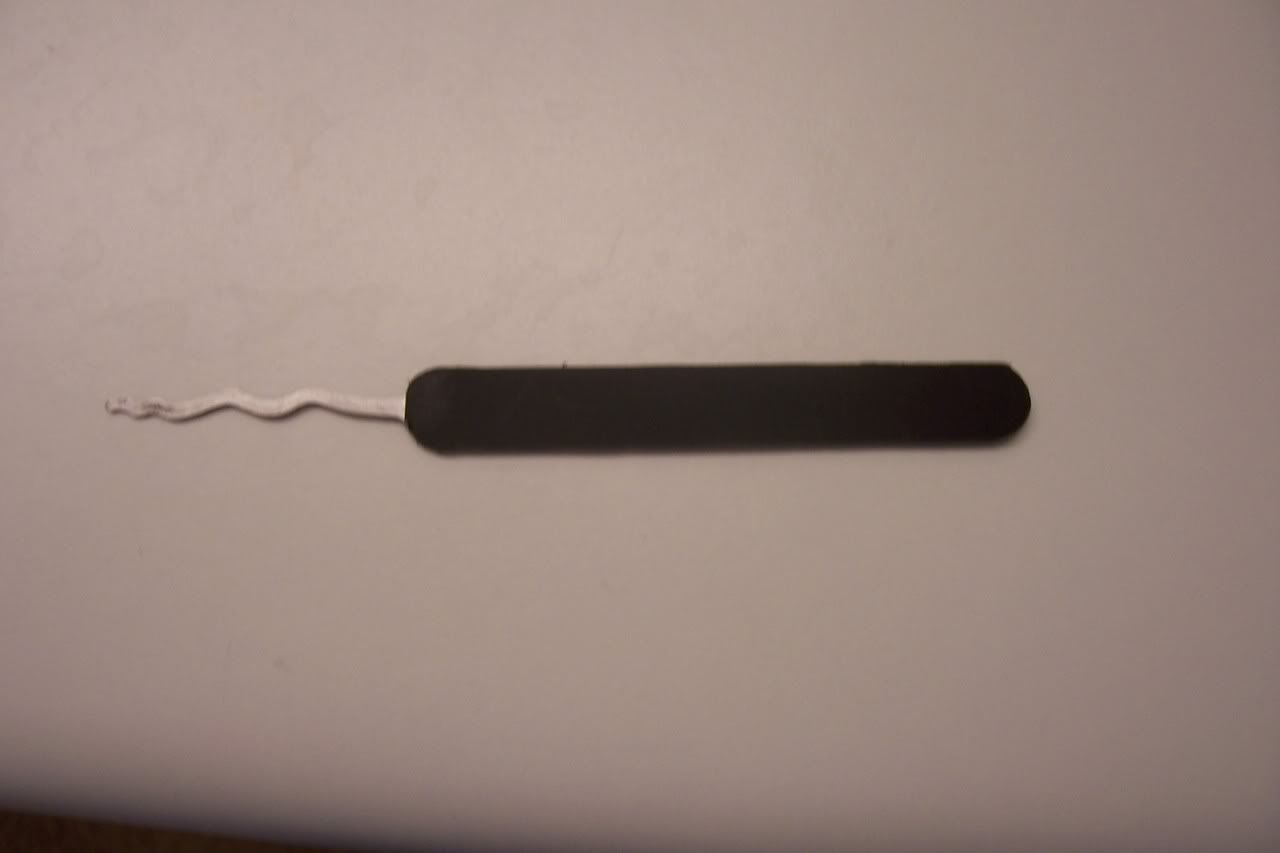

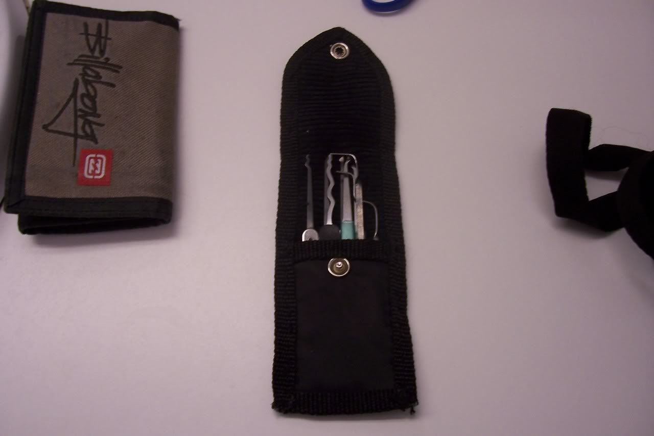

Postby _Ethereal_ » 22 Jan 2005 16:59
i finally finished a computer pick with handles, and also the case.
pictures are poor quality..i don't usually take pictures at 4 in the morning.

Postby _Ethereal_ » 24 Jan 2005 20:17
yes, but im too lazy to glue the handles, i think i will stick to the metal handles and rivets, or i will get some loktite because epoxy sucks for this.

Postby bembel » 24 Jan 2005 20:32
F**ck!
Didn't wait until the last pictures were complete, only got 56k here. :(
(Hail to the missing edit button... Image )
What kind of material did you use for handles?

Postby MrB » 24 Jan 2005 20:33
Superglue would be simple and of course it cures nearly instantly.
However there is a trick to epoxy resins like Araldite. Firstly, make sure you mix them exactly half and half, and thoroughly. Second, and most important, heat dramatically reduces the time to cure. Put the job in a warm oven at say, 80 C, and the resin will be fully cured in something like an hour.

Postby _Ethereal_ » 24 Jan 2005 20:34
Black sheet plastic, which is the same as sheet metal but plastic.

Postby bembel » 25 Jan 2005 9:51
Looks pretty thin to me.
Ever thought of using wood?

Postby _Ethereal_ » 25 Jan 2005 16:35
yeah, its the same as the picks thickness, yes i have, but im currently thinking of buying some Plasti-Dip for my handles.
