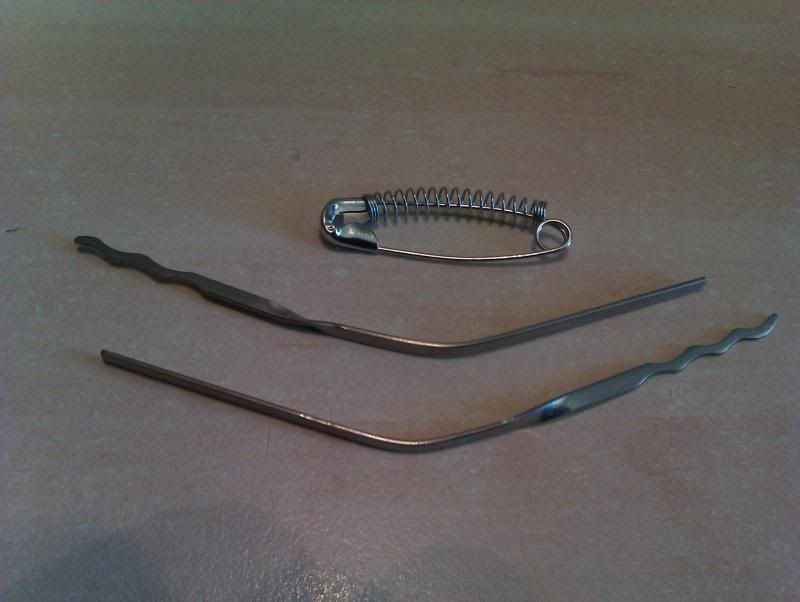

Postby mattc » 18 Apr 2013 8:37
To celebrate my anniversary, I've had a good go at making some Bogota/Bogota-style picks;
I've got some more shaping/polishing to be done...

Postby gunny » 22 Apr 2013 21:37
OUTSTANDING! Better than my efforts, but I'm still learning. keep us in the loop.

Postby mattc » 5 May 2013 4:57
I was lucky enough to find a pristine sweeper bristle the other day :)
mattc

Postby phrygianradar » 6 May 2013 23:13
I have been enjoying this thread and figured I would give making a bogota a try. I think it turned out ok, still needs some shaping and polishing and whatnot, but not bad for a first attempt; plus I have a bunch more street sweeper bristles left! :D
I have already tried it out and got some pretty tough locks open without much trouble at all. I like these picks/rakes; they feel nice and smooth when they are doing their thing. They feel very rhythmic to me.
