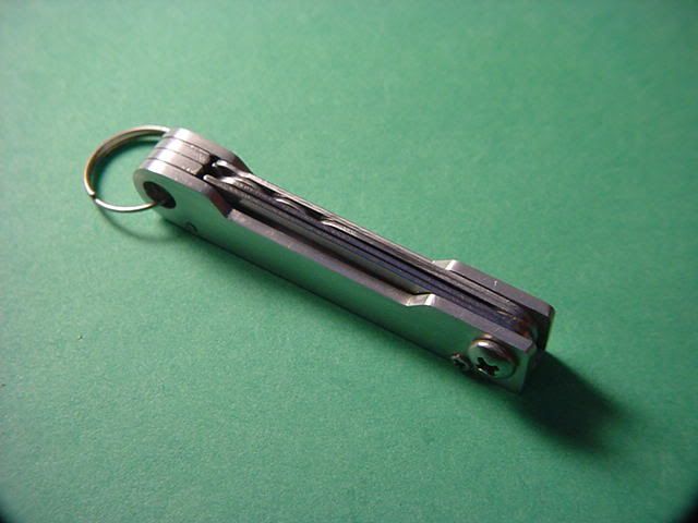

Kaotik wrote:Image
This is by far the most excellent jackknife pick I've ever seen!
(I think I know the 12 years old thing you refer to, but yours is so much better) ;)
Just perfect.

bembel,
Thank you for the kind words. I am glad you liked it, I spent quite some time on it making sure it was as close to perfect as possible.
It is similar to the 12 y.o JackKnife here on the site, I just made a few changes including the width to hold 4 pick blades instead of 2 and a wider notch on the side to make accessing picks more adventageous. Making it from aluminum stock made it lighter than i'd expect from stainless. No doubt stainless is better in some/all cases, much cleaner than a black metal like Aluminum, brass, sterling and gold, and when welded, grinded, filed and polished properly can make it look flawless.
I only used what I had at the moment to complete the project and I think it turned out well for looks as well as function. Thanks again.

Postby LockNewbie21 » 2 Oct 2006 22:03
Kaotic that does rock man.

Postby Double_Chin » 2 Oct 2006 22:16
I'm in awe of the craftsmanship/I wish I had one.

Postby Fah_Cue » 3 Oct 2006 10:03
Kaotik wrote:bembel,
Cheers. :D
How to guide! PLEASE :D
I love it! its ausome, so clean and perfect.
Where did you pick up the material? local hardware store?

Postby Kaotik » 5 Oct 2006 0:43
LockNewbie21 wrote:Kaotic that does rock man.
P.s Thanks a while ago for telling me about the magnifier under the camera for better closeups
Cheers Buddy :)
No problem buddy, remember you owe me one. :P j/k love to help out.
Fah_Cue wrote:How to guide! PLEASE
Hmmm, I will have to make another one to make a step by step guide on it, and it would be interesting to share with you all. I think I will give it a go.
The materials used for the body of the tool was Aluminum baught at Ace Hardware (some Aces have a small rack with various types and sizes of sheets, tubes cylindrical, oval and square, strips and rods made in Aluminum, Brass, Copper and Stainless) store for about $5 it was a .064x4"x10" piece. The small screws can be found in just about any old device you have no use for, and the picks were made from Paring Knife blades.
The holes were drilled and threaded for better results in this project. However, if taps and dies are not available to create threads there are other means of doing so. One is to find a drill bit just slightly smaller than the threading on the screw, drill the hole, then start to drive the srew in a few turns then back it back out, repeat but drive in further, repeat till screw is completely in. It may be time consuming but it works since the material is soft enough.

Postby iNtago » 5 Oct 2006 1:47
i'll be waiting cause my first try failed :cry: all my screws weer out of place , my aluminum was to thin and im plain not good at filing aluminum :(
so a guide will be great :D
