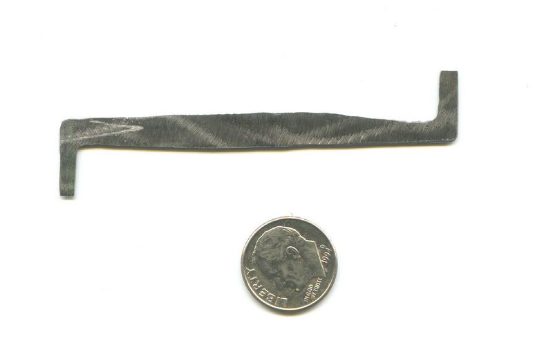

my imitation Peterson
Postby Spossum » 11 Sep 2006 3:00
I finally got a little free time a couple days ago and made an imitation Peterson style tension bar. I used a Red Devil brand putty knife like Gordon suggested. I cut it out using a Dremel. I still need to polish it up, and I may grind down the main shaft part a little more to make it thinner. I also might notch out the ends or serate them a little bit, I haven't decided yet. Anyway, the metal is a good material for tension bars, I think. It held up well to the cutting and grinding. It also feels good, flexible but strong. I like it alot, especially the size is nice for padlocks. Thanks Gordon.
Spossum
Posts: 92
Joined: 12 Aug 2006 8:41
Location: Kansas USA
Postby Kaotik » 11 Sep 2006 19:57
Your tensoin wrench looks pretty good. I can aslo see that the two ends are different sizes, good, that comes in handy for different size keways.
Some scrapers and putty knives are stainless and some are not, you will have t keep a lookout for these. I prefer stainless and other semi-non corrosive metals for my projects.
Good job, a little sanding in progressive grits of black automotive sandpaper will do it justice and make it look very nice. :)

new putty knife
Postby Spossum » 18 Sep 2006 4:06
I have ground down and sanded my tension bar. It looks alot better. I would do one thing differently next time. I used an old putty knife from my garage that is covered with dried up plaster, paint, JB weld, and who knows what else. By the time I ground all that crap off it there were a few pretty deep gouges. I still don't have them all sanded out. Next time I will just go buy a new putty knife and use it, because I am going to have to replace this one anyway. Should save a lot of work.
