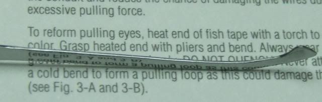

Postby headshot tM » 18 Feb 2008 13:30
Also, is my pick half decent? From your experience would it be effective enough to actually be used for picking?

Postby Safety0ff » 18 Feb 2008 15:29
The shaft looks a little thick to fit into tight keyways in my opinion.
