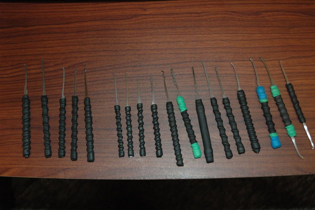

Sweet pics. Do you use a buffing wheel and compound, or just sand paper? I really like the 2 peak bogota, perfect shape.
I'm glad you aren't urked I posted picks with your handles, but I was pretty sure you would be cool with it.
The colorful handles are cool, but use in moderation. I went nuts this weekend trying not to copy your style exactly, and ended up with a whole case of candy sticks. Ultimately it's good to accent a set, but not as a theme.

I only use sand paper I feel a tool should never shine more then my car =P
I start off with about 220 grit and work on it for a while with that then I follow up with 600 grit dry (wet/dry paper) then I follow it up with wet 600 which really adds good shine.
And I know how the color goes when I first started making my handles I made them solid green and I ended up looking at it and covering it with black again.

Postby criminalhate » 4 Jul 2008 21:42
All of my home brews to date.
