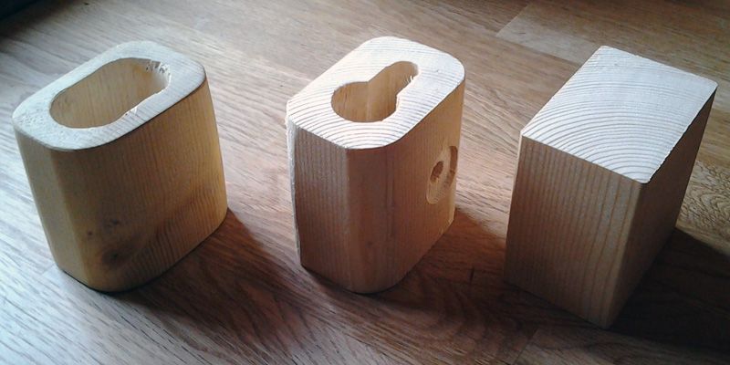

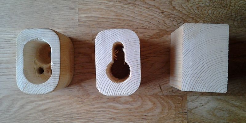

Here you can see three stages of my new cylinder holders, from right to left: a just cut block; one drilled for euro profiles and rounded corners with a chisel; the old one after I quickly smoothed the sides with sandpaper but the top part is still untouched. I like these a lot. Will post pictures when I finish them.

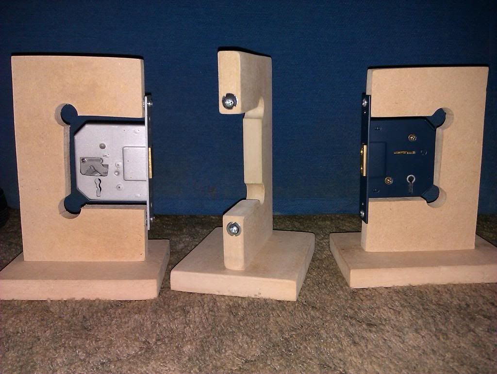

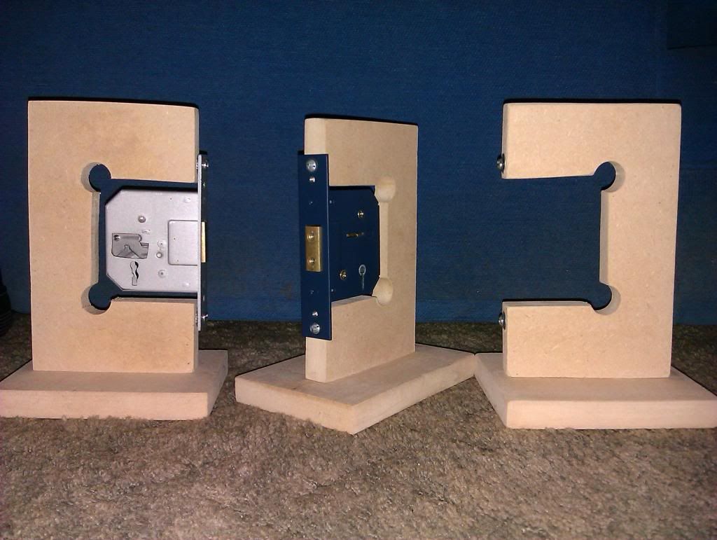

I've been working on a few practice stations for my locks, here's a sample
The fixings are for plasterboard; they expand when the bolt's put in for the first time, so it's good and secure plus it's metal on metal so I don't have to worry about the wood getting chewed up. And yes, that's a primitve home-made cutaway on the left.

mattc:
I like your lock mounts, very creative to cut the boards like that instead of trying to mortise the locks into a thick piece of wood.

Postby femurat » 3 Jun 2013 3:27
I can't believe I missed your post mattc! As Squelchy said, very nice stands. For a more realistic look you could add a couple of thin plywood sheets on the sides and make a sort of wooden sandwich. But they look great already.
