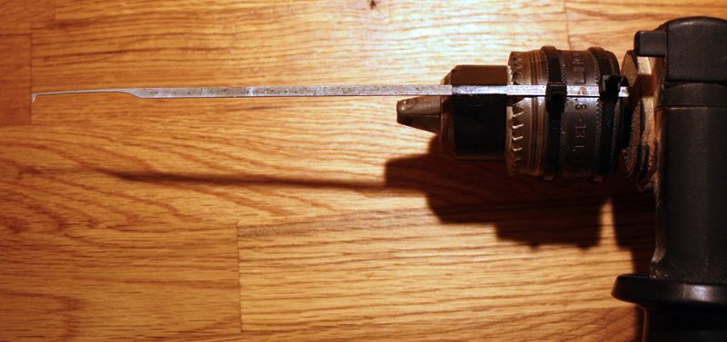

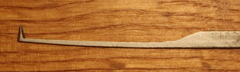

Postby femurat » 19 Nov 2009 12:28
I liked Chriss idea, but I tried to make it simpler!
This was just an experiment to develop the process, so I used an old and rusted bristle. There are some big scratches on the pick, next time I need to "clean" it before I start. Better if I use a less ruined one...
I roughly shaped a pick with a cut off disc on my dremel, a 3 minutes job.
Then I run the drill for a few minutes on the SandingBLOB. As you can see the pick is attached to the chuck so its speed is a lot higher than if it is inserted like a normal drill bit.
The upper part of the shaft and the handle are not finished, I need more sand on the bottle.
Anyway I think I got a very good result: the tip is perfectly sanded and its shape is not altered. 8)
I like this improvement. Next time I'll round a little the edges with a needle file and use the SandingBLOB just for finishing.

Postby raimundo » 22 Nov 2009 8:43
Thats some kind of dimple pick isn't it. those type need to be made for left and right handed locks, I try to taper/bevel both sides and make it universal. and more rounded less sharp. Yours would work even if the pins were not rounded on the tips, my double sided type depends on the bevel of the pin tip to get under the pin.

Postby femurat » 23 Nov 2009 6:19
You're right Ray, this is how I modify an half diamond to work better with dimple locks :)
I know what you mean about rounding the tip. With sandpaper it's automatically rounded. In the SandingBLOB the shape is unaltered. I have to consider this aspect when I shape the pick.
Also, when I make double-side dimple picks they tend to be sharp like knives. Maybe it's better to make them with a flat edge and then just round the edge with sandpaper. I'll try this.
