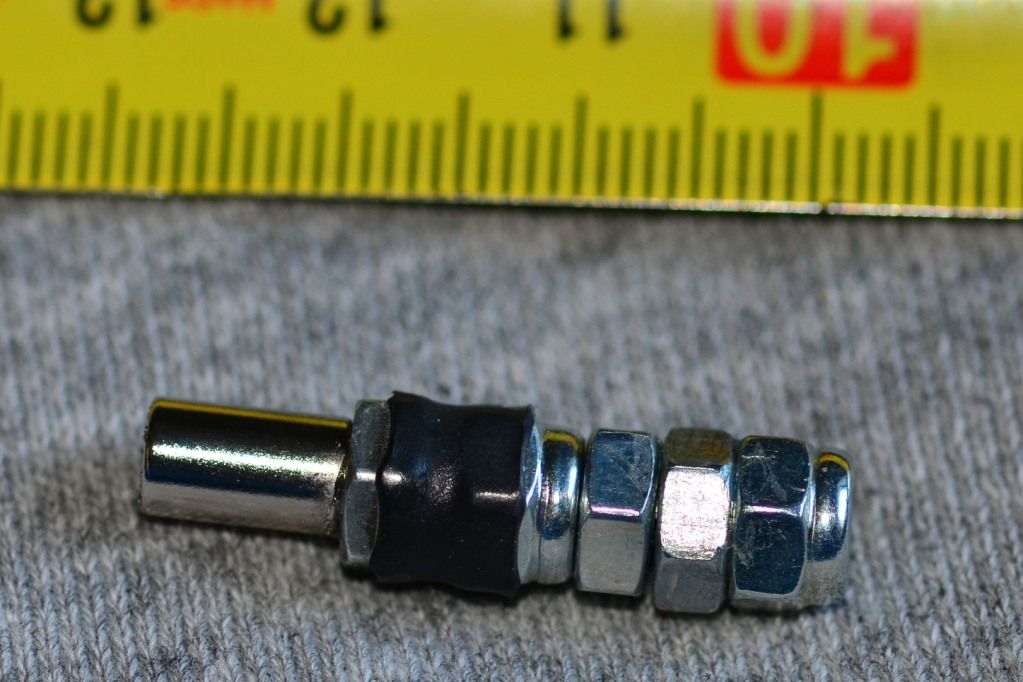

I made my version with a few improvements or at least modifications.
There is room for at least six picks and one folding tension wrench inside. Sharpie´s tip is used to hide that it isn´t a working pen.
All picks are made from street bristles, width 3,2mm. I made a groove to every pick so that index finger rests on it. It helps when you rake, with spp it doesn´t matter so much. Picks are very tight fit so they don´t come out easily accidentally.
The folding tension wrench is explained here http://www.lockpicking101.com/viewtopic.php?f=4&t=55262
They fit very well inside and it doesn´t rattle at all. There is one neodym magnet which holds all the picks and tw in place, also preventing from rattling around.
This is the housing for the picks. It is a M4 bolt which I split in half with dremel for 18mm length. There is a short heat shrink tube so that it goes tightly in place, it also centers it well. I will also use some glue to provide permanet fitting in the pen. And at the other end is the magnet glued.
This is the housing from the frontside showing the split bolt. M4 nylon nuts proved to be perfect size for my bristles. There is one nylock nut in either end of the split bolt to provide as little movement as possible. It doesn´t wiggle at all.
Original pen weights 22 grams and this version is 32 grams so it´s not so heavy it would be suspicious. Not until you are asked to borrow a pen... :wink:

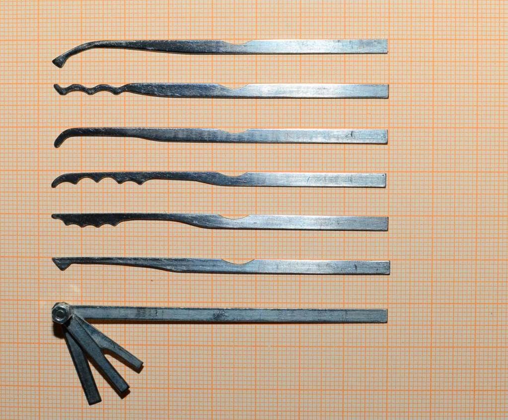

Postby zeepia » 6 Aug 2012 13:07
Here are my picks of this nice project, they are laid on a millimeter paper so they are 77mm long. These have already beaten a lot of locks 8)
Enjoy!

Postby zeepia » 7 Aug 2012 0:15
I´m not saying these are the most excellent pick shapes there are available! But these looked about right in my eyes, I made these without any templates.
My deforest goes a little too deep and bogota still beats usually those two rakes. One with inside and other with outside curve. But it always depends on the lock you are playing with.
Take some time searching this site and learn what picks are usually preferred, and if you make them slimline you can use them in tight keyways also.
Just remember to sand your picks very smooth and then some more polishing.

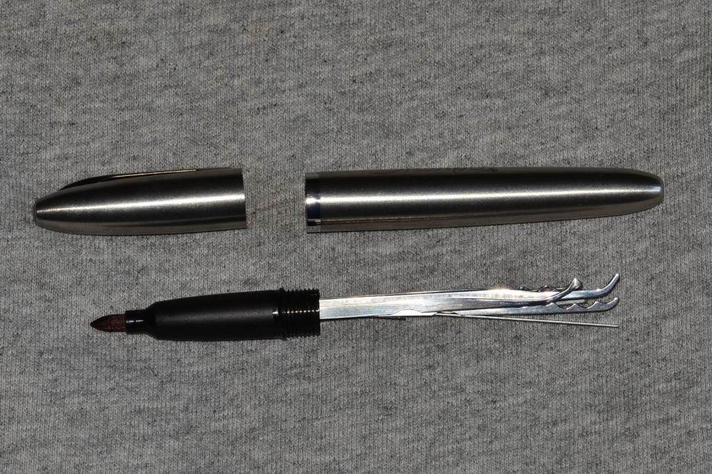

Postby t|n|< » 25 Aug 2012 15:33
My version of the Sharpie pick pen.
I wanted to get it so the sharpie marker still worked, and I think I did! Here's what I did:
1. cut down sharpie refill right behind threads, (tape off extra half of refill, save for refilling later)
2. cut down X-acto knife 1/4" behind groove - I don't know which number x-acto it is. Sorry! It's the most common one, I think.
3. pull out felt ink insert from the pen half of the refill and cut off 1/2", replace ink insert in pen.
4. wrap extra thin rubberband around groove on X-acto. I used a really cheap, really, really thin hair rubberband. Braces bands or a tiny rubber o-ring would work also.
5. carefully push x-acto into the pen half of the refill, making sure the rubberband doesn't slide out of the groove, if possible. It should hold the X-acto inside the sharpie.
6. (optional) I added another red rubberband on the outside, because one little part of the internal rubberband was showing and I wanted it to look like it was on purpose...
7. Cut your picks to size, so it can be closed with your favorite pick ready to go, clamped in the x-acto.
I hope the rubberband and threads of the x-acto housing are air tight enough to prevent the sharpie from drying out. We'll see. I'm fully expecting the sharpie won't last that long, because of the small size of the ink insert. But it should be easy enough to replace later.
Currently, I still need to work on it so it doesn't rattle and make my tension wrench, but I'm very happy with it thus far!
Hope you like it. :)

Postby zeepia » 26 Aug 2012 4:31
Nicely done! Love the feature that the pen is actually working :)
You could put a small neodym magnet there to prevent the picks from rattling around. When one pick is already in place in handle, they shouldn´t make a sound.
