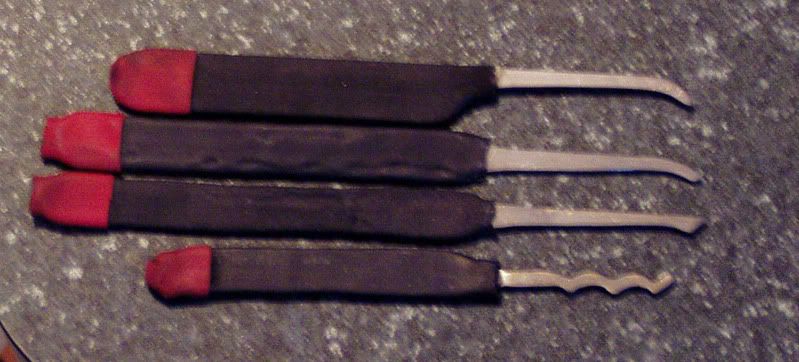

Hey there heres the start of my first pikset. Just thought I'd contribute.
So far, I have a half-diamond, medium hook, bogota rake and a completely homemade jacknife.
The case is aluminium and the picks are hacksaw blades.
The tension tool was a piece of stainless steel. I have heaps left (half a square meter) but find it too flexible, well actually it doesnt have the spring of hacksaw blades, just bends and stays bent.. I also have two other tension wrenches but theyre just old hex keys grinded down so nothing special, hence no photos of them.
Sorry if the photos are too big...
The gang together...
Cheers

Postby LockNewbie21 » 6 Dec 2006 10:56
Nice pieces mang black and red is wht i use on my picks to, its the only sizes that works for picks that they sell at harbor frieght :P

Postby UWSDWF » 6 Dec 2006 11:03
look a little big
Postby REparsed » 6 Dec 2006 11:59
Sometimes I like the feel of a wider pick if there is enough room in the key way but in general the thinner the better. I think the best way to gage how thin you can get with the pick shaft is to file or grind a little and then try the pick in an actual lock. Keep grinding and trying till the pick gets so thin it breaks off in the lock (Did I hear someone say never pick a lock you depend on?) then make another pick ALMOST as thin.
Different materials demand different minimum thicknesses, so experiment.

Postby mjwhit » 6 Dec 2006 14:31
yeah cheers guys for the feedback.
they work fine for me but ill bust out the angle grinder tonight. :twisted:
not too sure about continously making them smaller until they break though, sounds too much like suicide... might try it one day when im bored...
haha lock newbie i hope you didnt think i copied you it was just some spare heat-wrap lying around that i saw. running out of red though--maybee three picks left if I'm lucky.
WHat do you guys reckon I should make next? im a bit stuk for ideas. From the feedback I guess maybee a smaller/shallower hook? Not a huge fan of rakes...
I thought they were allright for my first picks though.

Postby iNtago » 6 Dec 2006 14:42
try deep curve hooks
make them a bit smaller and sand and you will have a nice set
also try to find wiper inserts so you can have more tension wrenches

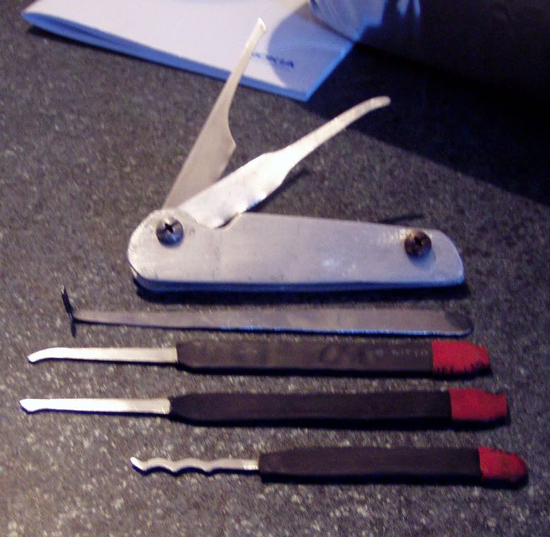

Postby mjwhit » 7 Dec 2006 3:15
i made a deeper hook as iNtago suggested. Heres a pic.
The new one is the at the top if you didnt know.
Do you guys still reckon theyre a bit wide?
I did cut them a tiny bit but think ill go and do more tomorrow, getting dark...
Im getting faster anyway, that one took about quarter of an hour plus sanding and heat-shrink.
I definately reckon I need some more tension wrenches.
At work there is pretty much an infinite amount of brick strap that gets put into a metal bin, might get some tommorow, and see what its like.

Postby Kaotik » 7 Dec 2006 19:12
mjwhit: Not bad but they as well as the newest one still looks to wide. The goal when making a hook as you may know is to minipulate individual pins, so it must be made thin enough to do so, but not to wide to interfere with the adjacent pins.
All in all, a good job on the shapes.

Postby mjwhit » 8 Dec 2006 0:28
Nice picks man.
You seem to have a flair for photography as well.
Just curoius to how that pen thing works, did you make it yourself?
How do the picks clip in?
Pretty nifty little idea really...

Postby REparsed » 8 Dec 2006 1:21
Nice work.
Gotta love those Xacto knives. While waiting for some street sweeper bristles I made a couple picks out of the pocket clips from Pilot Precise pens. The only way to hang onto them was to chuck them into an Xacto knife handle.
