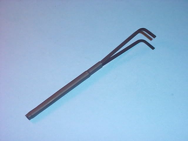

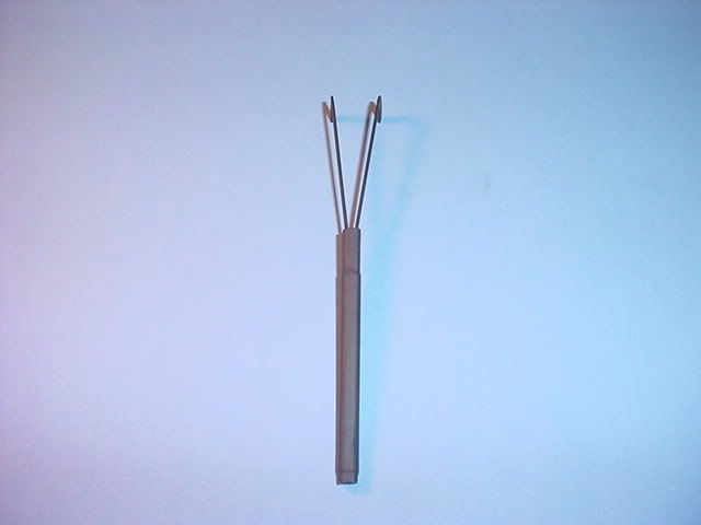

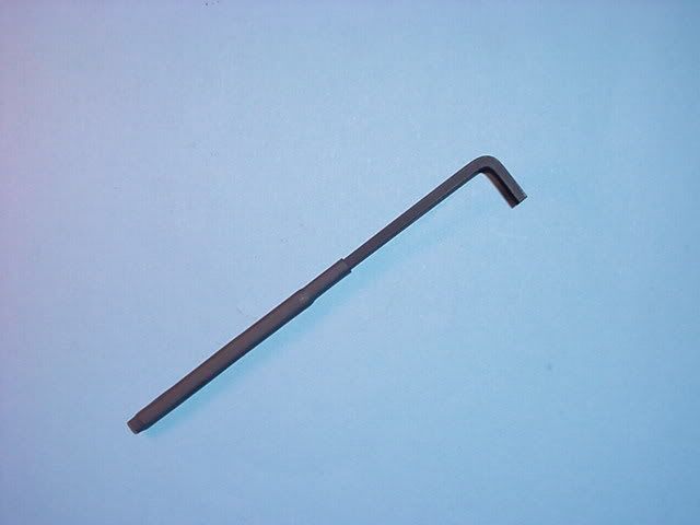

Here is a double prong tension wrench I recently made. It is made from street sweeper bristles bent along it's axis to stay flat.
Used 4 pieces total, 2 longer pieces were for the outside working ends and 2 smaller used as spacers, painted them black with high temp enamel then wrapped in heat shrink tubing for a better grip. Because the shrink tubing would not hold tight enough to keep the outside pieces from sliding out while turning, I put 2 spot welds to hold them all together.
I was thinking of making a how-to article with pictures to help others make one if they have access to the equipment. Also, I have made some tension wrenches with small teeth that resemble the Petersons that lay flat and will post a pic of one later.
What do you guys think, how-to or no?

yeah make a guide, but how well does it work?
Postby Kaotik » 10 Dec 2006 16:12
It works as well as any other DP Tension tool I have used, the slightly thicker handle takes some getting use to but since they are spot welded together, little feed back is lost.
The moderate to advanced picker will notice the little change since they have had the practice and experience to notice the feed back for what goes on inside the lock better.

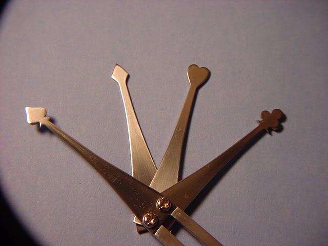

Postby Jason13 » 13 Dec 2006 4:56
Thanks kaotik for making us look like Crap :shock:
LoL just joking Nice picks man, Are you going to take a overhead view for some nice Templates :P

Postby mjwhit » 13 Dec 2006 14:22
:shock:
Wow jason13 did you really make those???
The detail in the spades and club picks are amazing...
Ever tried picking a lock with them?
If you can open a half-decent lock with the club pick I will be even more impressed. :lol:

Postby parapilot » 13 Dec 2006 14:34
kaotik made them. Look a page or 2 back.
