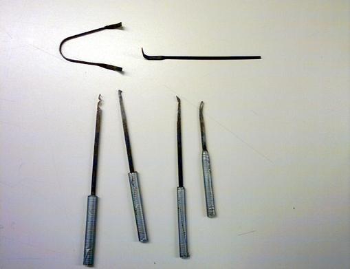

Several years old, but still work great. The old street sweeper bristle trick. Nothing like .032 spring steel and duct tape. Well, okay... almost anything beats duct tape when it comes to picking.
