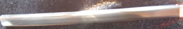

What's up everyone? I have been making some smooth stuff, but for today you only get to view the junk.
Rather neat little duo. I have already turned the smaller short hook into a tensioner as well. I left the copper color on as much as possible because I like the contrast.
ImageAs you can see the looper is thinnner than a standard wiper blade. At least as thin as a polished pick from a wiper blade just for torture testing.
ImageBefore torture testing. This is the shorty.
I have broken the loop after 3 hours of newb style heavy handed picking. I bent it back about 12 times from a 30 degree bend. To make the story short you could not break this pick without months of standard abuse, or so much tension that it would be next to impossible to set binding pins. I am impressed by it toughness and feedback. Not as good as stainless for me, but next in line just for ease of malliablity and toughness.

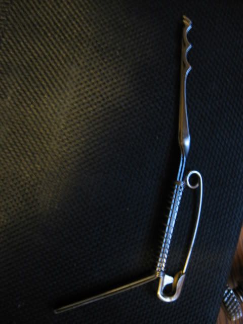

So, in my many failures I have happened upon some decent ideas. This first early idea for a "transforming" pick was put down when I realized I am a cheater, and dispite any radical perspective it's two picks.
"TRANSFORMED"
Originally there were supposed to be alternating cuts in the handles to accomodate holding the spring for the "transformation" but when I realized regular bogota sets could be connected in the same fashion I trashed the idea and just left the grip cuts, which also function to hold the spring firmly in place on a bogota sheath pin. The additional cuts would have been useful as teeth for the tension wrench function as well, but I don't like the way the teeth dig into brass for everyday practice tools. I have been using these alot so forgive the fact they are scarred.
Before I made these I had been carrying a hook around in my case for a couple weeks. An extra pick and a tensioner that took up minimal space. It came in handy so much I had to try something like this. Props to Raimundo for originally combining the two. They are so universal I rarely need to carry anything else which explains why my last few posts have been bogota.
