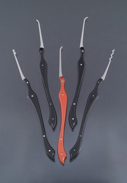

Postby ghost1 » 30 Dec 2008 17:46
ratyoke: feel free to post the black handled ones you made for me over here in lil old England, just because i love the black anodised finish and they are mint and should be shown off. I am still useing them every day and they show little sign of wear.
LOVE your work they are my "weapon of choice" SUPERB.

Postby ratyoke » 30 Dec 2008 22:23
I like the black quite a bit too.
Red pick was for Roxylass in Scotland.

Postby ratyoke » 15 Jan 2009 17:19
Probably won't be making anymore like these, at least not exactly like these. They look simple, but they were way too much work.

Postby Jaakko » 16 Jan 2009 6:28
ratyoke wrote:Probably won't be making anymore like these, at least not exactly like these. They look simple, but they were way too much work.
Round bar, mill with a slotting disc, a ball form tool bit on a lathe and 10 minutes + the actual pick heads? :)

Postby ratyoke » 16 Jan 2009 17:37
Jaakko wrote:Round bar, mill with a slotting disc, a ball form tool bit on a lathe and 10 minutes + the actual pick heads? :)
Pretty much, except I used a file to make the round ends. The set up for cutting the slots was one of the difficult steps for me. Along with tapering the thickness of the pick steel.
The entire handle in 10 minutes? You are clearly a better machinist than I.

Postby Jaakko » 16 Jan 2009 17:57
Well, looking at those pictures it looks to be just a rod with turned grooves, rounded ends, a few axial grooves (which by the way can be done on the lathe also, just use the carriage as a broach), a some sort of hole in the end and then two holes for the attaching screws/rivets (on a drill press).
Insert stock in the lathe, center drill, use live center, turn the grooves, switch to broaching tool, make axial grooves, rechuck it to near the chuck, drill the end, switch ball end forming tool, form the end, flip around and form the other end. Put in the drill press, make two holes. Easy 8)

Postby raimundo » 17 Jan 2009 11:54
Slot the whole rod for both picks as one piece would help in just eliminating having to reset material in the lathe.
The design also looks like it could incorporate a set screw and have several extra tips from sweeper bristle size stock in a drilled out back end, for using the handle storage for several tips. obvioulsly the concept may need refinement, a pressure lock like a vise grip has would be a good way to tighten the tang of the pickshaft, You could cap the end with a screw in spite of the slot and with proper fitting of that screw, it would also prevent them from dropping out that slot. Well its an idea that I had looking at it, there are commercial attempts at makeing picks with tips held in the handle, but most of them are not that good, I am sure some of the talented pickmakers here could prove that it takes artisanship to make something like that well.

Postby ratyoke » 17 Jan 2009 16:30
Jaakko wrote:Well, looking at those pictures it looks to be just a rod with turned grooves, rounded ends, a few axial grooves...
Yep that's what it is, but it still wasn't fast for me to do.
I never knew about cutting a slot with the lathe like that. I will try it someday.
Its not a hole drilled for the pick. There is a slot cut all the way through the handle for the pick. If you look at the top edge of the top pick you can see barely see the steel along the edge. I thought I took a pic showing it, but I can't find it.

Postby Jaakko » 17 Jan 2009 16:31
ratyoke, how did you make the pick ends and from what?

Postby ratyoke » 17 Jan 2009 16:43
Jaakko wrote:ratyoke, how did you make the pick ends and from what?
1mm high carbon steel feeler gauge stock. Drilled holes for the screws. Ground them on a grinder to close to the right shape, filed the taper in thickness so they are .5mm at the tip. Finished shaping them, rounded the edged that were requested to be round, sanded and polished.
