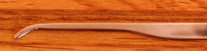

Postby femurat » 23 Mar 2009 5:43
I went to the junk yard this saturday so I asked for some dipsticks... after one hour and a half (10' dremel with cut disc, 10' needle files, 1h sandpaper, 10' test it during the process) I got this beauty! The dark parts in the pictures are shadows: it's surface is like a mirror!
This is my first pick made with a dipstick. It was a lot harder than bristles to file and sand down. The pick is the stiffer pick I have ever tried. It's also the thicker, in fact it works only in less restrictive keyways.
The next project with this material is an half diamond, as soon as my fingers are back from their well deserved rest!
Posts: 3769

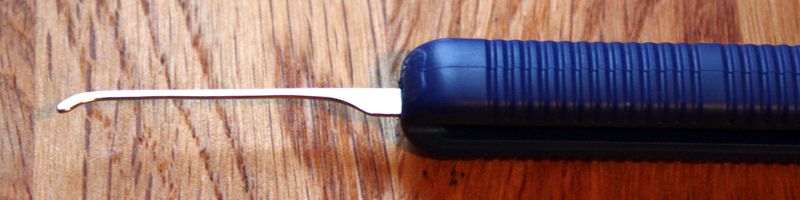

Postby femurat » 2 Apr 2009 7:53
This is a specially short hook I made to play with a very restrictive keyway.
It's very thin but the feedback is excellent!
Posts: 3769
