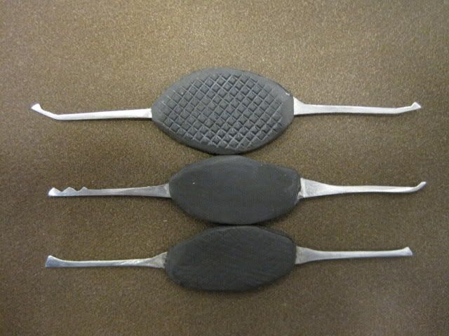

Here are picks that I mostly use.
Hacksaw blades, Topy Pyratop rubber and adhesive.

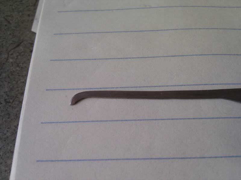

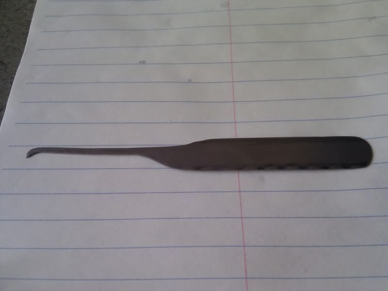

I can't belive what masters are here, now I'm ashamed what piece of sh.t made I (I made my first 2 lockpicks and 2 first tension wrenches) - my stuff can't be putted in side with your homemade tools, but here I post images you can see. Next time I will make better tools too.
For lockpicks, I printed a template from templates-post , then I cutted out the template from paper and atached it on hacksaw blade with paper-glue. Then I cutted a hacksaw-blade with knauf-profile scissors. That's why the lockpick is so ugly. (i didn't have an electrical file to file it).
Tension wrenches - I made them from Torex-keys (just filed away one end so it can enter the lock..)
My next tools will be much better I hope ;) .
My first picklock (i made 2 but 1 of them already broke) and my first 2 tension wrenches :
