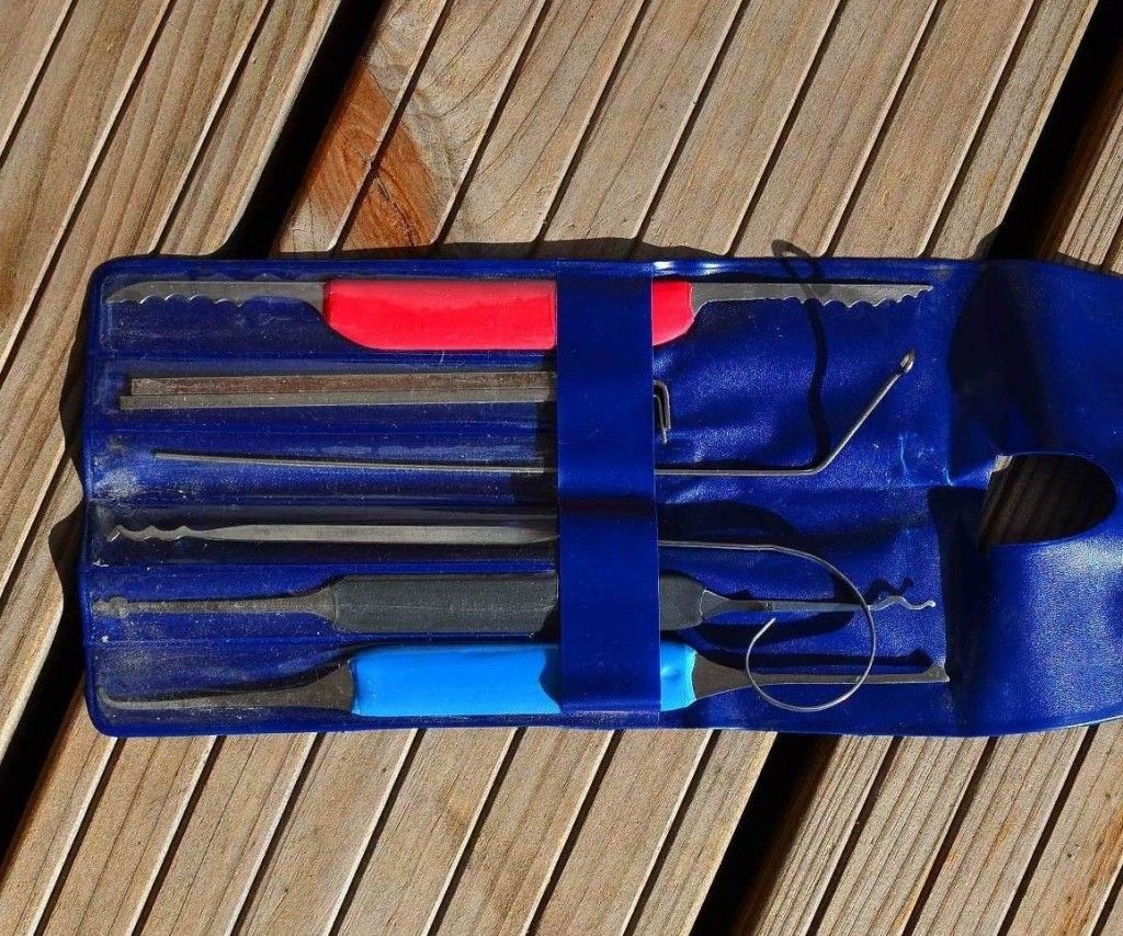

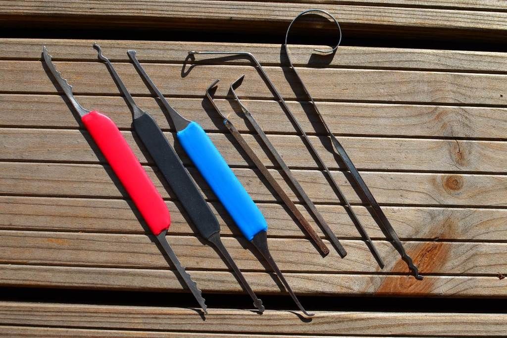

Postby zeepia » 17 Jul 2012 11:49
Made this handy set mostly for AVA and every other cabinet locks seen here. Yes, there are scratches but that´s because I use these a lot :lol:
Coloured picks are made from hack saw blades and bogota from street bristle. Second from the right is for AVAs bottom tension, shadow shows what shape it is. Works like a charm.

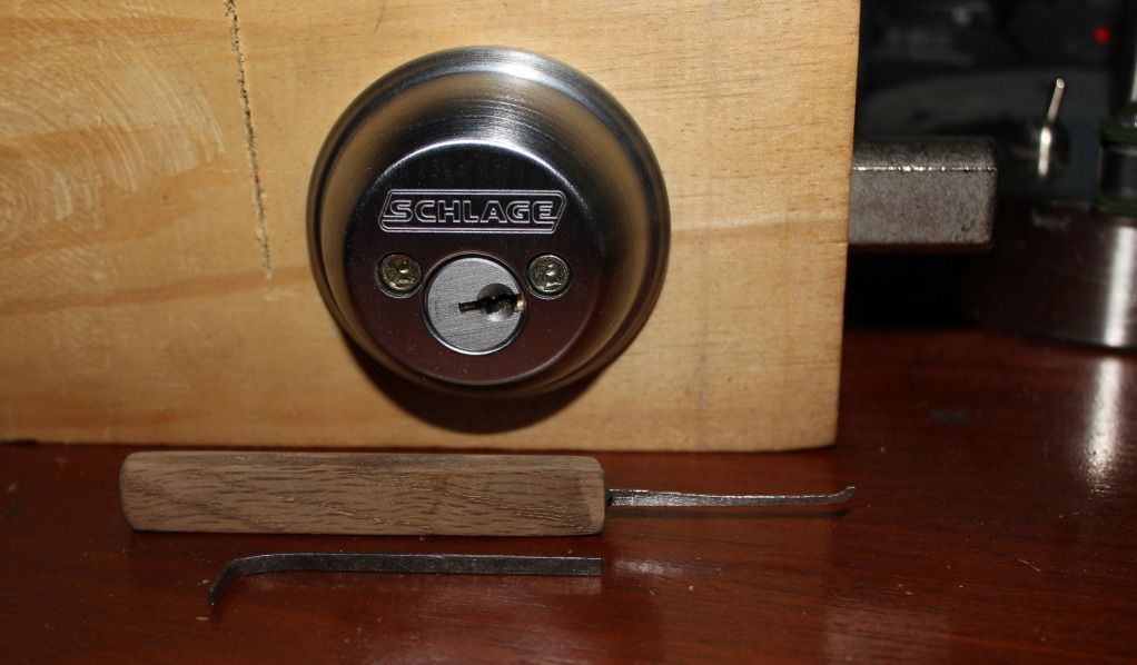

Postby Scajaquada87 » 10 Aug 2012 22:59
After acquiring a used street sweeper blade, I was able to produce both a hook pick and a tension wrench. So far I've picked a few Kwikset cylinders, some Schlages, a Kawneer and a knock-off Yale with just these two picks. This tension wrench was actually surprisingly useful when picking the knock-off Yale in the counter-clockwise direction--my HPC and Peterson Flat Fives just aren't that great for top-of-keyway tension on this particular cylinder. For the handle of the pick I used two strips of wood that I sanded. There is a channel that runs through the center to accommodate the pick. Everything is held together with epoxy glue. Pictured below are the two picks. The locked picked is a five pin Schlage with spools in three of the stacks (although only one tends to snag).
