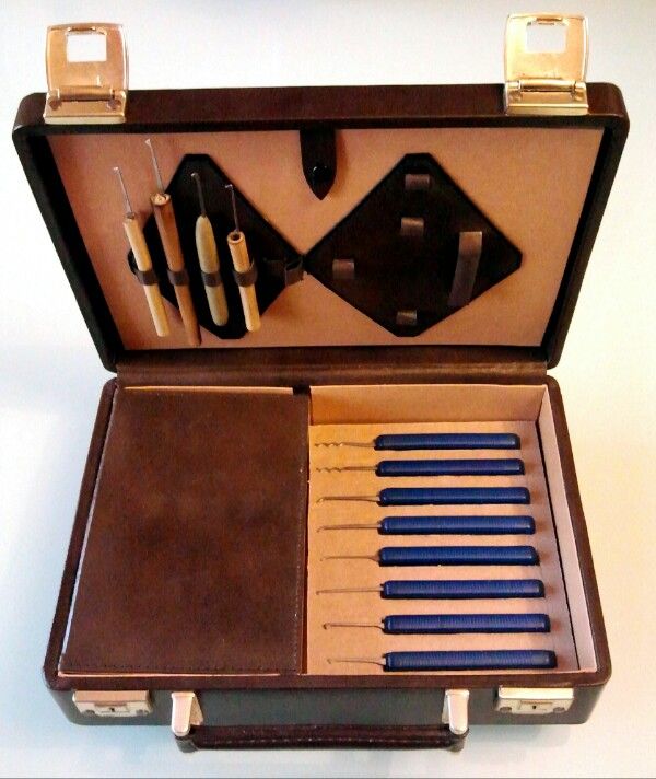

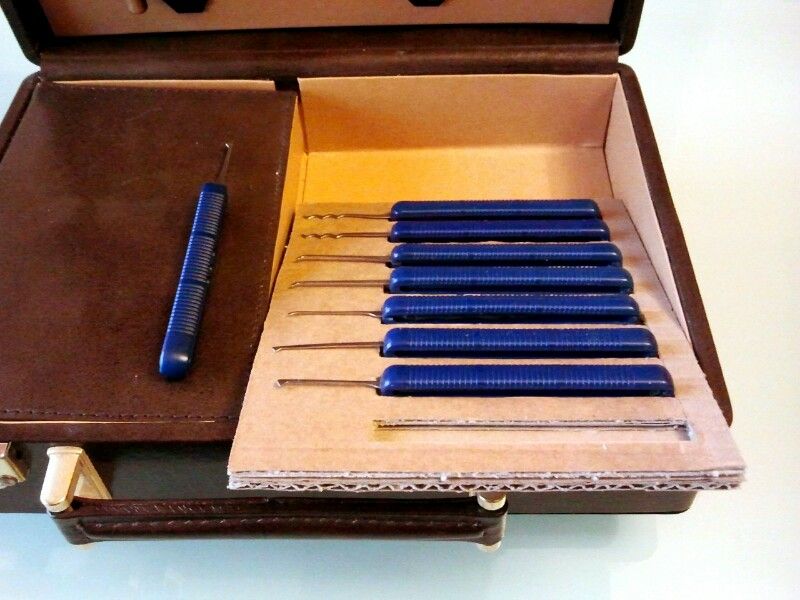

I have my most used picks in a small box, so I always have to dig through them to look for the one I need. Since I inherited this small old suitcase, I decided to use it to store and organize my picks. I made a prototype with two pieces of cardboard. I cut some slots to accommodate the handles and glued them together. I plan to try it for some time and see if it works.
I need a rubber band to keep the picks in place but you got the idea.
Still don't know what material should I use for the final product. And have to figure out another panel to hold the wrenches. Suggestions are welcome.

Very nice pick case! That looks very professional compared to any scroll.

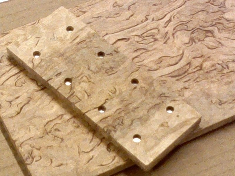

I´m loving magnets so I suggest them to you too. I inlayed two for each pick in my pick box, this way it doesn´t scratch and looks cool in finished product. And keeps picks in place.

Thanks. I saw your case, very cool!
So you just drill a small hole and glue the magnet in place? Looks a lot better than the rubber band I was thinking about.
I may use magnets for the wrenches. I'll check if it's able to attract the steel bristle inside my Gillette plastic handles.

I think you need too much magnetism to get through your Gillette handle. I inlayed mine to grab the shaft, there is only about 1mm of wood between to make sure picks stay in place. And those magnet´s pulling force were about 0,9kg each.

Didn't thought about that, I'll check if a strong magnet under the shaft is enough to keep the pick in place. I guess so, since these picks are very light.

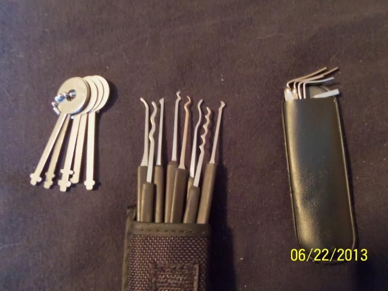

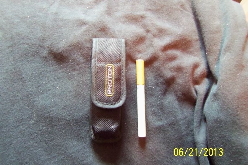

This is a pocket set using a 1 AA proton pro flashlight case. I have several sets of varying sizes.
Often worn on a paracord neck lanyard or in my pocket when I was not on the job but wanted some tools handy, though it has a belt loop also.
This case is small , 1 inch wide x 4 1/4 inch long and the picks were made to fit (4 1/4 inch) in so the top will not allow any tool loss when closed like some fold over cases do, and I just like smaller handles.
I made these tools, except the warded keys, from windshield springs and they were quick and dirty so be
forgive my workmanship please, I can do better.
The tension tools are in a half size fingernail file holder which slips in the pouch to keep them separate.
Anyway the focus here is the improv case .

Looks awesome!
I like your picks, very good looking! :D
