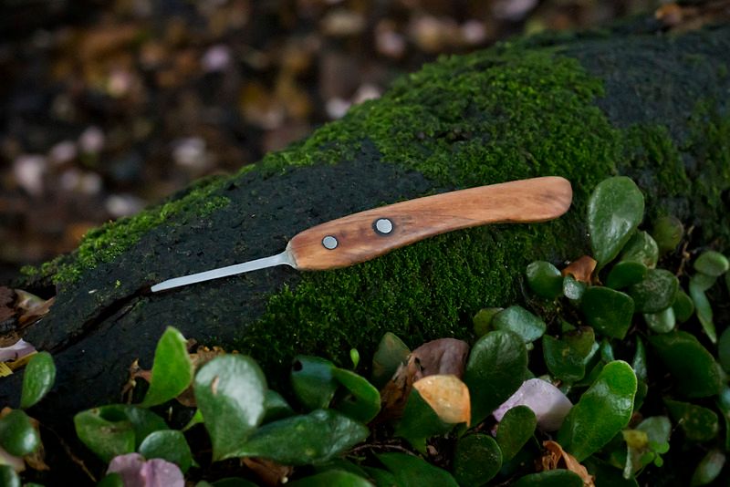

After a long hiatus, I had a successful experiment today. My first wooden handled pick, but it looks and feels so good I might find some exotic woods and make a few sets as gifts for the locksmiths in the family. Going to make the next handles slimmer, and plan the shape in advance instead of just freestyling it.
Decoder in 10/1000th feeler gauge. Recycled NZ Native Rimu. Used epoxy and grinded off a few bolts to use for the pins. A fun afternoon in the workshop. :)

Very nice I really like the look of it, nice rustic look. A whole set like that would be awesome. You really framed the pic good to. Great job

Latestplague[] wrote:Very nice I really like the look of it, nice rustic look. A whole set like that would be awesome. You really framed the pic good to. Great job
agreed on the rustic look. A lot of picks out there are just made to look "tacti-cool", but this pick and handle design are very classy and have a warm feel to them.

They look great. They look sleek & like squelchtone said classy. I really like the shape you went with Iv seen some carved handles and I wonder how they even hold em. What kind of feedback do you get with them? I have never tried wood handles before.

Postby mjwhit » 26 May 2016 19:10
You do lose a little feedback vs plain metal, I suspect due to the layer of epoxy in the centre. Still give decent feedback, and they are very comfortable to use.
Still- My next ones I think I will press the steel into the handles, use more pins, and even thinner wood.
These are 7mm edge to edge, so Im thinking of using something like a wood veneer which is 0.6mm thick, two layers of veneer on each side of the pick, and using superglue instead of epoxy. Also should cut down on the time it takes to make because I can just cut the rough shape out with a blade before attaching them and they will be the correct thickness already. Also it has the advantage of being able to source exotic woods easily as a veneer.

That sounds like a good idea. It looks like you used larger pins on the decoder, which I thought looked great. I would think but I'm no expert that the larger pins would give you more feedback by having more metal for the energy to transfer into and a larger contact area for your fingers and they look great, 3 of them evenly across the handle I can just picture it in my hand haha.
I have stayed away from wood because I did read someone talk about the feedback. Iv carved wood handles for things for years , usually Woodburning designs or grips into them so it's something I have considered. Needless to say when I see someone do some as well as you have it makes me wanna carve something. I have also about quit super glue, gorilla glue has been my go to for things lately especially if I'm gonna press or clamp them anyway. The 1st thing I did notice was when they say it expands 3-4 times they mean it. Anyhow the picks look great definitely something you should be proud to have made, can't wait to see some more.

Postby mjwhit » 27 May 2016 21:15
Yeah, the decoder pins were massive. I was going for a slimmer/sleeker look with these ones.
You should definitely give it a go. Ive been looking at how the penturners make their pens, def some really cool things possible with different layers of different wodds/inlays etc. Even crazy things like layering in aluminium and stuff could be fun.
Ive finished a few more using only superglue instead of pins, and using a bench vice to press the steel into the wood while glueing instead of having a epoxy layer between two pieces of wood. So far so good. Drilling small holes in small pieces of tempered steel was a real pain- even on the drill press, so if I can do without drilling I definitely will. Prob be ok with some better drill bits I guess.
