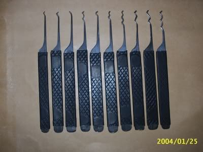

by scampdog » 26 Aug 2006 17:49
having bought some of Rai's picks, i can't praise them enough,the only problem, is that i am stuck in a forgotten era, when only popsicle stick handles were the thing. Rai's picks work superbly, but i could not get on with the grips. taking this into account ,i scavenged rai's technique and put this set together to suit my type of picking,hope you like them.

by bonez » 27 Aug 2006 1:31
very nice scamp!

by raimundo » 27 Aug 2006 8:56
Looks very nice, one of the better sets I've seen, have fun with them.
