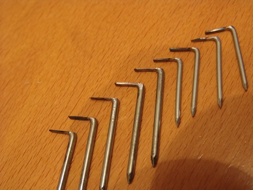

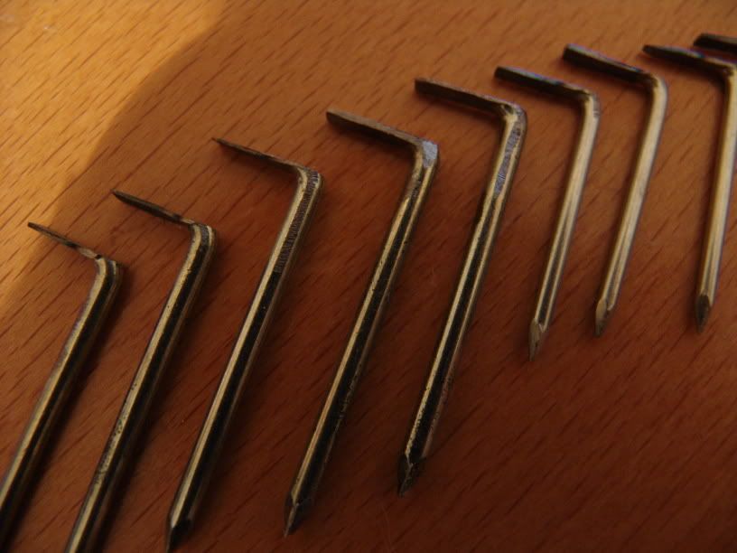

I never managed to make any good tension wrenchs using a torch and hacksaw blades. They were always very fragile. But I made this nice ones:
I just found some nails that had a bend like a tension wrench, I just needed to grind them a little because they didn't fit the locks. I have diferent thicknesses on them so, some are stronger and some others are more fitable. They are hard, I mean you can't apply much pressure on them because they don't bend and so a heavier pressure makes it impossible to push the pins. Anyway, they work pretty well once you got the touch... and come very cheap.
