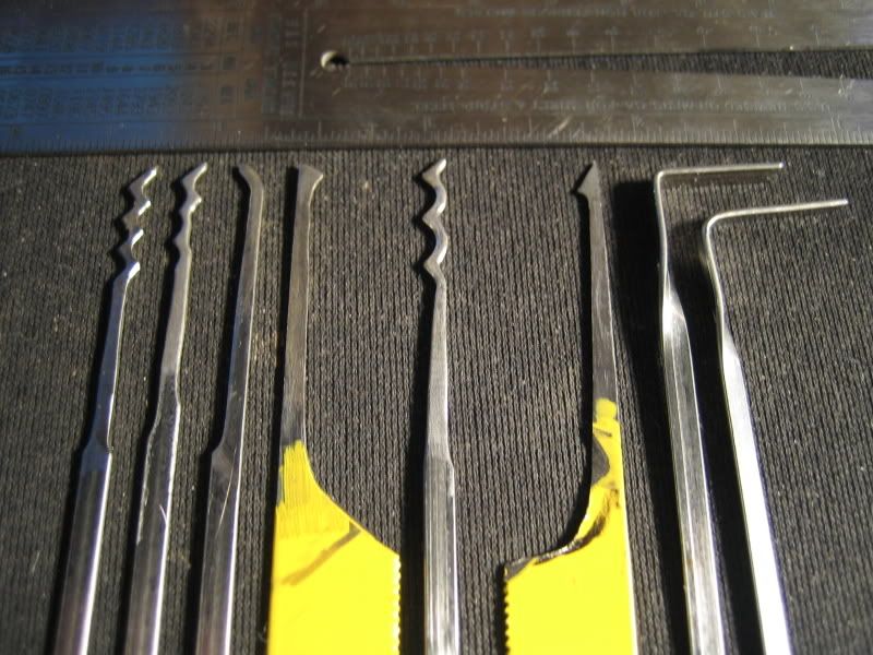

Postby jgencinc » 18 Feb 2006 3:08
took some pictures of my picks. Any suggestions on what other pick types, or modifications to the ones I made would be greatly appreciated.

Postby CPLP » 18 Feb 2006 10:33
I think they are just fine for first time!

Postby Bahrg » 18 Feb 2006 11:51
I cant tell if its just the way the light is hitting them or not, but some dont look like the tips are very polished. The first one looks so, but not sure on the others. If not only suggestion I would make is polish them a bit more otherwise they look good to me :)

Postby jgencinc » 18 Feb 2006 23:25
I've been practising with some newer rakes I've made. I'm getting a lot better.
As for the polishing of my picks, I'm trying a lot of diferent types first. I don't want to waste a lot of time cleaning up picks that I won't even use much. I sand them enough that they feel smooth to the touch. Once I find some I like, I'll duplicate them, and shine em up.
