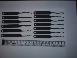

this is in response to a request by pickmaker about my homemade computer picks.
http://i39.photobucket.com/albums/e157/ ... rpicks.jpg
the picks are made from0.60mm feeler guages (for uk guys they are available from Warehouse Direct tel-0845 600 2601,for only 1£ a set 1mm to 0.05mm,they also do cheap hacksaw blades as well,ask for a brochure). The templates for the picks,were obtained by combining various pictures on the net,and enlarging them in stages untill i reached what i thought was about right(taking account of pin spacings). Due to the curved shape, the majority of the work was carried out on my bench grinder,and fine tuning with the good old dremel. They were then polished using different grades of wet and dry paper,they were then finally given a high polished finish with dura glit cloth. i also made a hook,diamond,rake and king and queen picks. it's a handy keychain item.Be glad to answer any queeries if you want.

Postby Demonithese » 14 Mar 2006 23:38
are they european picks? (im assuming, since your UK)

Postby scampdog » 15 Mar 2006 4:33
i've tried them on all sorts of pin tumbler locks(US as well) they seem to work just as well on either.

Postby sams choice » 15 Mar 2006 13:23
i like those alot! they look really nice. :)

Postby Demonithese » 15 Mar 2006 14:57
do you... by chance have the templates? these picks look awesome.

Postby scampdog » 15 Mar 2006 20:18
hi demonithese,hope these are of some use
http://i39.photobucket.com/albums/e157/ ... plates.jpg
you will probably have to enlarge then about 60%,let me know how you get on.

Postby pick_maker » 16 Mar 2006 21:28
Nice effort. I would like to use the template but try saving at a higher resolution - at least 72. Thanks.
