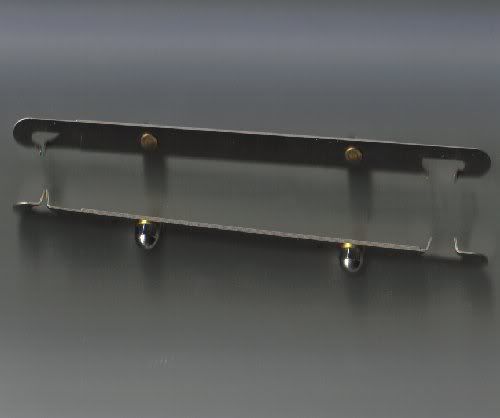

Postby SteveW » 30 Apr 2006 18:41
Hi guys check these out :wink:
These are ajustable tension wrenches from the Falle pick set. The two prongs allow you to grip both the top and bottom of the keyway, and make it simple to reset the pins. They are completly rigid which takes a bit of getting used to but the feedback is superb. These are the only tension wrenches that i use now.

Postby vector40 » 30 Apr 2006 19:07
Yes, something just like that would be nice, but a good double-pronged wrench is not easy to come by.
